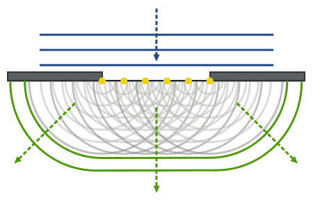

Hi. I was studying Huygens Principle and I learned that diffraction usually occurs more when the slit is comparable in size with the wavelength, and this image does not leave my head:
Diagram of Huygens' principle for a slit: a plane wave from above, shown as blue lines, passes a gap and spreads as circular wavelets, with green arrows showing the wavefront bending outward at the edges.
We can see that the "middle" part of the wavefront keeps traveling in the same direction, but the wavefront in the extremities starts to propagate as spheres. My question is, can we determine the intensity of some cross section of this "new" wavefront
A. in the middle
B. in the extremities
I'm having this questions because I was wondering why lasers are collimated, as the light leaves a small aperture. Is the aperture big enough so that no diffraction can be seen? But eventhough no diffraction can be seen, it still occur right? For example, if I am in a plane perpendicular to the beam, and the laser is in the vacuum, will I still be able to see the beam due to diffraction? What will be the intensity of the light seen?

This diagram is very misleading. The actual energy lying outside the central portion is very small. Close to the aperture we have a parallel beam, surrounded by some small blobs of energy. If you are a long way from the aperture, we see a central diverging beam surrounded with many lesser fringes. The first of these is roughly 1% of the intensity, the next 0.25% and then getting gradually less until when we get to 90 degrees from the beam the intensity is only 10^-5. If you look at the aperture from here I think you will see glowing edges, assuming your eye has a large aperture.
The laser beam diverges at small angle when measured at large distances and is surrounded by a succession of minor lobes as I have described. If the laser hits a screen we see the main lobe surrounded by circular fringes gradually fading away.

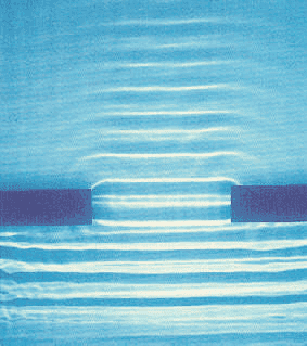

I think this may be the 'nub' of your question. You start with that (good) diagram of diffraction through a fairly wide slot. That assumes uniform illumination across the slot and this photo of a ripple tank shows the same effect well.
Ripple tank photo of water waves passing a wide gap between two dark barriers, with curved wavefronts spreading out beyond the opening and stronger wave crests through the middle.
It's a rare example of a really good ripple tank image. Someone went to a fair bit of trouble to get it right and posted it in Wikipedia and it not only shows the shape of the wavefront but also the amplitude. Much stronger along the middle than where it spreads out at the sides.

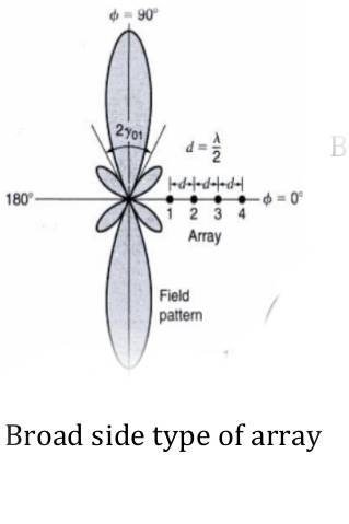

I will make my usual remark about how straightforward it can be to consider Radio Antennae when trying to understand diffraction. The diagram below shows the pattern of a row of four sources, co-phased and a crude version of the infinite number of Huygens sources. The pattern is bidirectional in this case but , of course, all the light ends up in the rough direction of the incident beam. A wider array (more elements) produces a narrower beam. Filling in the gaps between the elements to, say λ/4 or λ/8 etc gets closer and closer to the Huygens infinite set of sources.
