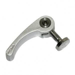

Or make a special nut with side screw or side clamp locking .
Consider a nut that has a cam on either side, operated by one lever.
Run the nut down the thread until it first contacts, then swing the lever over to apply the axial force.
There will be very little wear on the thread since there is no pressure while thread turns.
Not all Loctite is non removable.
rbelli1 said:
This? It is something like Baluncore described.
I do not recommend those lockable nuts.
Attached is a picture of a similar concept to my suggestion. But make it an over-centre cam that is big enough to contain the 20mm nut.
