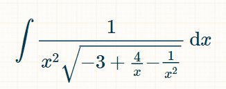

Calculate the following integral:
N/A
from this point I tried a u-substitution by letting u = -3 + 4/x -1/x^2 but this seemed to fail.
Are any suggestions possible?

Try factoring the quadratic under the root sign first. You should be able to find two linear factors.

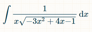

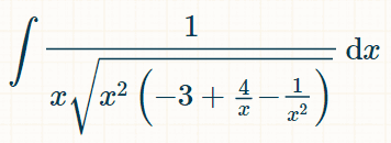

Alright I have the indefinite integral factored for the argument however I am unsure how to proceed.
I'm going to let u = x-1 which means x = u + 1 and for the second factor (3x-1) = (3x - 1 - 2 + 2) = [3(x-1) + 2]

There's usually several substitutions that work for these types of problems. The simplest one seems to be ##t=1/x##. At least that seem to work for me (but I did this rather quickly so I may have done something wrong).
Another approach that should work would be is to complete the square and then use the standard substitution ##\arcsin## but in this case it seems to be rather complicated and you would need another substitution ##s=\tan t/2## after as well.
That looks like I would complete the square of the term under the square root to get something to match arcsec or arccsc. 1/(u √ (u2-a2) is the one I believe i am thinking of..
