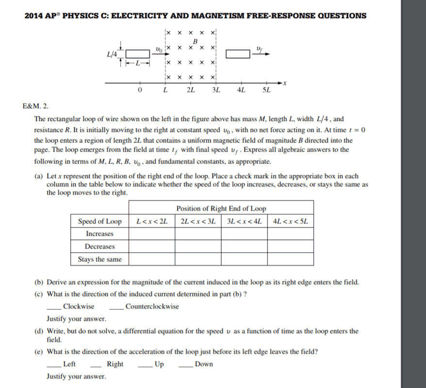

The discussion centers on the incorrect application of the area formula A=L^2/4 in calculating electromotive force (EMF) in a wire loop. The user derives the differential area dA as L/2(dl) and subsequently relates it to the velocity v, leading to the erroneous equation -BLv/2R=I. The correct approach requires recognizing that the effective area in the magnetic field is (L/4)*x, which results in the accurate equation -BLv0/4R=I. This highlights the importance of using the appropriate area for flux calculations in electromagnetic contexts.
