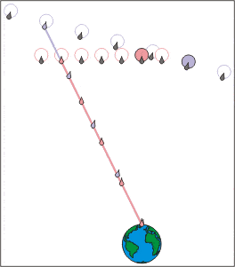

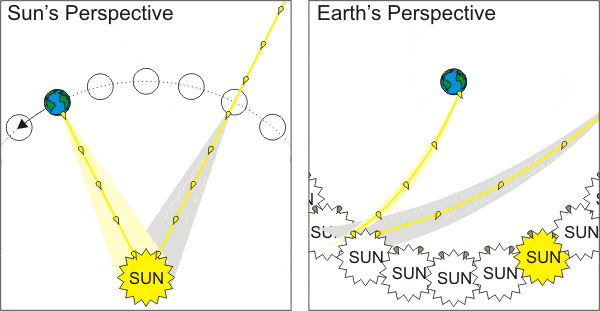

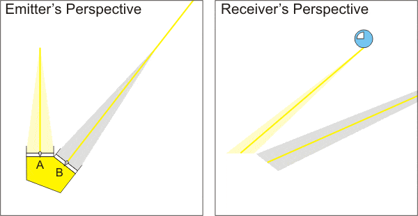

Also I have a whole series of diagrams that I believe show how it works which I have created. Can diagrams be incorporated in these posts? Is it permissable for me to show what I am meaning?
You can certainly upload attachments and images. But I'm not sure it will help.
