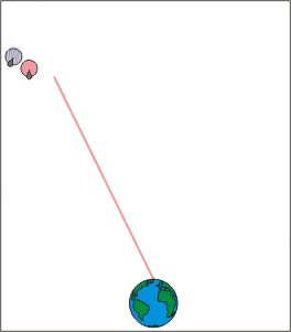

Then how should I be drawing the motion of the Sun in relation to a stationary Earth?
How can I fix my animation?

I think I see the reference frame you are using for earth. It has no rotation or tidal locking with the Sun and is rotationally fixed with the distant stars or CMB. Thus the moon fixed on this frame from the Sun POV would appear to orbit the Earth once a year, but not at all from this Earth frame POV remaining fixed in one constalation. With Earth origin (0,0) orbiting the sun using that POV you are plotting the instantaneous positions of the photons as the appear to move relative to the (0,0) origin of that Earth reference frame.
Looks ok to me as long as you remember it is plotting apparent positions of some photons that never will be observed at Earth directly. Therefore some rules like FTL can be seen as being violated just like shadows can move FTL.
What are you using to make your animations, seems you build reasonably quick. Does it have an option to allow viewer to step animation frame by frame?

I'm just using my old workhorse Corel Suite 12 to do my animations Randall. In reality it is a pain staking process of adding each piece in Corel Draw, converting it to bitmap, and adding it frame by frame in Corel Photo Paint.
The only way I can think to allow anyone interested to look at it frame by frame is for you to save the animation from the web page and load it into some other program. I can save it as a .mov file but this forum will not load that format.
You got the orientations I'm using in one. I did that to simplify the model as there are of course other factors to complicate things such as Earth rotation and wobble, Earth's dance with the moon, Earth's elliptic orbit, different mediums that the light travels through such as air, possibly the Sun's rotation and wobble (I want to look at Sun rotation shortly), the gravity wells, the observer jumping up and down, and probably other factors too.
I have just tried to maintain the same spatial relationships between all the actors Doc. All the distances between things are the same in both pictures. It is only because of the arc nature of Earth's orbit that this curve is translated to the right diagram. If the orbit were shown as flat rather than circular then the translation would be a straight line.
Is that wrong? Should the photon instead be shown as taking a different relative path when considered from Earth's perspective than the path it takes when considered from the Sun's perspective?
I thought at first that maybe a consideration of GR would straighten the line but from what I can tell it would actually increase the curve instead; not decrease the resultant curve. The photon when it leaves the Sun is in a deeper part of the well than the Earth is at any point in its orbit. Am I correct that under GR that paths are longer the deeper you are in a gravity well; even though under an X,Y,Z co-ordinate system we still see them as being the same length? If that is correct then this will make the journey the light takes out to the Earth longer increasing the amount of arc the Earth will transcribe before the light reaches it? Is what I just said rubbish?
Anyhow, principally we are looking at a simplified model. I had just thought GR might help to straighten the line hence the detour.
If I have a straight line for the photon in both diagrams then this will describe a different relative path for the photon. Is that thinking wrong? Would making it a straight line in both make it correct for you?

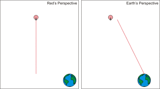

Is the following animation okay Doc now that I have redrawn the two perspectives to have a straight line from emitter to receiver (even though the two pale yellow backed paths are now not spatially identical with each other against the surrounding actors between the perspectives nor the two grey backed paths with each other)?
The left attachment is the animation showing my attempted correction from the last animation and the right attachment is a static image showing each of the time positions superimposed for closer comparison.
I have also adjusted the speed of the photons so that for the Sun's perspective they travel at the speed of light relative to the sun and for the Earth's perspective they travel at the speed of light relative to the Earth. Is this okay?
So, as far as the Sun is concerned they travel directly to where the Earth will be and take that amount of time and distance to travel; yet as far as the Earth is concerned they travel directly also to where the Earth will be but instead take the amount of time and distance to travel to where the Earth was; not where it ends up being. Is this correct?
Have I taken one step too many; or was this a good extra step to take?

I actually think your first diagrams were a more accurate representation of the reference frames you were describing. The curves you had shown should not be plotted as straight lines in the Earth Frame. I’m not sure what reference frame these new plots show.gonegahgah said:Randall, I just thought I should clear up that the grey backed path is not meant to be a shadow. Instead it co-incides with the face that was actually facing the Earth when the photon and face, represented by the pale yellow back path, were sent that actually end up colliding with the Earth.
Remember, the plots you had made was for where in that Earth frame the photons were for given intervals of Earth frame time. Of course they plot as a curve in that frame but the photon is still directly observed as going straight, which you had also shown in your original diagram by depicting the photon in a rain drop shape showing the direction of travel when observed, and only when observed. I don’t see the need to eliminate the curve, you seem to be correcting something that is already correct IMO.
Also I did not say your plot was a “shadow” but was like a “shadow” and you must retain that and understand what it means. For example you substitute two high speed objects moving at 0.999c East and West measured by Earth Frame observers. Collecting the observations will clearly show a FTL separation of the observations recorded. Often this is miss-identified as FTL by is “Like The Shadow” FTL effect. Picking either object and using SR nothing is FTL. Just like Hubble expansion produces FTL measurements without FTL local events. (note you cannot calculate the solution using real photons traveling at c dividing by zero problem etc.)
So IMO you need to retain your curves, and expect apparent FTL & STL photon measurements in some cases. Because if you Warp the frame to account for the needed space-time curve to produce a straight line, it can only by done for one of the two photons your discribing since they are different vectors in both frames.

I would tend to agree with you Randall. I would also like to know what are your thoughts on this Doc?
I've attached the unchanged animation from the previous post again and this time also added a second attachment of a static image showing each of the time positions from the animation superimposed for closer comparison. This is the best I can do I think where I can't provide a means to step through the animation frame by frame.
I still have the question about depicting the photon rate of movement. From the Sun's perspective the distance between where the photon emits and where it hits the Earth is shorter than for these two events in the Earth's perspective. Under the SR rules shouldn't I be depicting the photon as taking longer to reach the Earth in Earth's perspective; and less time to reach the Earth in the Sun's perspective?
This isn't a pivotal question for the diagrams that I am looking to explore but while we are here I would just like to know if that is the correct answer under SR.

On second thought, I agree. You were treating the Earth as an accelerating frame, which is OK.RandallB said:I actually think your first diagrams were a more accurate representation of the reference frames you were describing. The curves you had shown should not be plotted as straight lines in the Earth Frame. I’m not sure what reference frame these new plots show.

That term 'accelerating frame' sounds good; thanks Doc.

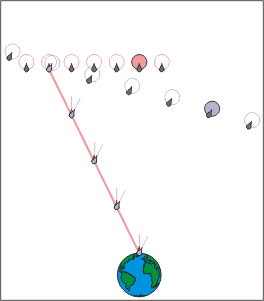

I did use the rain drop shape for the photons as you say Randall because, one reason being that the rain analogy is often used, but I did want to depict their orientation from the Sun and to the Earth that you mentioned.
I've attached another animation and composite static image. They are not much different to the last pair. This time they additionally not only depict the photon that reaches the Earth but also the face of the Sun that reaches the Earth.
They show the same face that the photon (the one that reached the Earth) was a part of is the one that reaches the Earth and not the face that was facing the Earth at the time both photons were emitted.
At the moment by this animation, where as you mentioned Randall that everything maintains orientation to the background stars (or CMB), we would end up seeing the current orientation (face) of the Sun that we are currently in front of but what it looked like approximately 8 minutes ago.
So is that still okay Doc? That is - taking into account Wikipedia - that we see:
1. the Sun not where it actually is in the sky but back where it was 8 minutes ago
2. but we see the face that is 8 minutes of arc further forward around from where we were 8 minutes ago
3. as that face looked 8 minutes ago.
Step 1 & 3 should be in line with Wikipedia so I'm just mainly wanting to confirm principally no. 2 at the moment. Does this all look okay from what you have been explaining to me? Is the attached animation okay?

Seems reasonable to me.gonegahgah said:So is that still okay Doc? That is - taking into account Wikipedia - that we see:
Assuming the programs are broadcast out in a narrow beam (much like a laser), I would agree with your statements.gonegahgah said:As I mentioned, Animal Planet is showing on TV A and BBC is showing on TV B. So when the vessel is directly above the platform - by the ephemeris data - Doc then is it correct - reflecting the nature of photon showers - that the vessel should only receive Animal planet and not be able to see BBC from where they are? In both perspectives?
