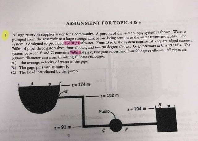

Summary: Currently having issue with fluid hydraulic homework.
Only put down Bernoulli’s equation on my paper
