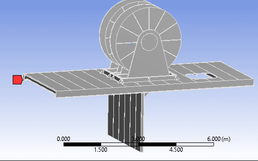

I am currently working on my final project. I need to model the effect of bending stress "inside" a plate of ship's deck with Ansys Workbench.
Here is a review about bending moment that cause the bending stress.

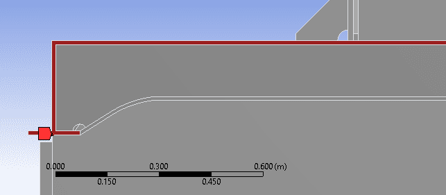

One can obtain the stress which is happened on a specific location using the -My/I equation. I want to apply the stress "inside" the place of ship's deck. Here is my finite element model.
As you can see the red arrow above marked the location where i calculate the stress according to the sectional profile of that "frame". I want to apply the stress from that left "frame" to the other end right "frame".
I have three options.
1. Applying a pressure on a surface, this surface, (where i calculate the stress). The red region is the place where i apply the pressure.
2. Applying a moment on the same surface with option 1.3. "This is what my supervisor wanted me to do" Applying the stress inside the plate from left frame to the other end right frame. I don't know how to thatwould you like to help me?

Actually i am doing a research about the strength of that drum thing/winch roller drum, on the deck, by applying a tangential force on the drum.
But for the sake of detail, i want to include the effect of "difference between the ship weight and buoyancy when ship subjected to a wave train". This difference caused a bending moment. If one knows the 2nd moment of the section, the stress and force can be calculated.
What i am asking, is there any way i can apply that "force" inside the plate of the deck? In Ansys.
You can think as if there is a "stress flow" moving from one end to the other end
Calculation by hand, one can apply the force on nodes inside the plate (nodes of the mesh) and then solve it numerically.

And i know the 2nd moment of the lateral section of the left end (the frame). Its 13.5 m squared from its neutral axis.
I know the location of the plate and girder (the T beam, see the red region i mentioned in the 1st post), from the nuetral axis.
So i can calculate the stress that location, multiplied it by area of the red region, i have the force which i attempted to apply "inside the plate" not only on the "surface" of the red region.
Thank you so much for going this far. I appreciate that.
Ok, we have been having a small issue related to what I would specify as a resultant "force" on the end of the beam caused by the bending moment on the ship's hull at that point rather "a moment on the beam". Now that we are past that, then your red arrow pointing to the right represents the force at the left end of the beam that results on a compressive stress on that longitudinal beam. In order to create a compressive stress in that beam segment there must be an equal and opposite reaction force at the right end of that beam segment and that can be addressed by treating that end as a longitudinal restraint and compressive (or under some other wave pattern distribution along the hull a tensile) stress throughout the length of that beam segment will be constant between those to reference points.
Next, it appears that you also want to investigate whether or not the currently selected wave pattern distribution along the hull at a given point in time, as opposed to one that has progressed some increment of distance along the hull, results in the maximum compressive force on the beam and deck segment you are analyzing. To do that requires at a fundamental level means determining the moments applied to your region of interest by taking multiple snapshots of the hull's bending moments as the of the wave pattern progresses along the hull; but, this may not be practical, so you are also looking for an alternative method of determining those successive moments, and therefore compressive forces on your beam segment.
