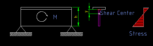

Diagram of a beam section under a bending moment labelled M, with height h, a cross-section showing the shear center and a triangular stress distribution plot labelled Stress.
Hello all,
I am a new member of PF.I have a basic question about the bending stress, I remember somewhere I saw this part, but can't find out it. Could you give me a answer?
Given:
1, M-moment applied on the section.
2, I-Section modules
3. y-distance from shear center
Solution
F,how much is the force at point y?

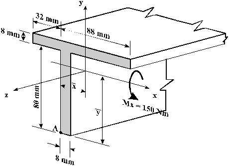

In the section below:
Diagram of a T-shaped beam cross-section with a 32 mm flange top width, 88 mm overall depth dimension, 8 mm flange and web thickness, 80 mm height, and bending moment Mx = 150 N-m shown on axes x, y, z.
the bending moment Mx = 150 N-m and the centroid of the section ##\bar y## is located as shown. In this particular section, ##\bar y = 66.40## mm.
##\bar y## would also be the distance used in the bending stress formula above to calculate the bending stress at the bottom edge of the web.
(Note: The second moment of area for this section is I = 1,202,840 mm4)
The bending stress at the bottom of the flange is
$$σ = \frac {M ⋅ y}{I} $$
$$σ = \frac{(150 N⋅m) ⋅ 1000\, mm / m ⋅ 66.40\, mm}{1,202,840\, mm^4}$$
σ = 8.28 N/mm2 = 8.28 MPa compression
The bending stresses will be distributed as in this diagram:

Hello Steamking,
Thank you for your guidence.
I am much more want to know hou much is the force rather than the stress, the moment can be equal to a couple of force, and the stress is caused by the force?
Based on the definition, we can get the following result
F=σdA, A=σdy, σ=ky
If I were wright, what's the solution of this equation?

The shear center doesn't play a role in calculating bending stress, but the location of the neutral axis does. (The neutral axis and the shear center are two different things).
If you want to calculate the force over a particular portion of the cross section, dF = σ ⋅ dA, and σ = M ⋅ y / I. For a particular distance y from the neutral axis, the bending stress is constant all along that line, just like along the neutral axis, σ = 0. The bending stress σ is proportional to y and the constant of proportionality is the quantity (M / I).
Diagram of a T-shaped beam cross-section with a flange 32 mm wide and 8 mm thick on top and a web 8 mm thick, with dimensions 88 mm and 80 mm marked, a bending moment Mx = 150 N·m shown, and point A at the bottom of the web.
If you wanted to calculate the force acting on the web below the neutral axis, you would proceed thus:
dF = σ ⋅ dA and
σ = M ⋅ y / I
From the previous calculations,
##\bar y = 66.40## mm above the bottom edge of the web
The web has a constant thickness of 8 mm, so dA = 8 ⋅ dy, where dy is the height of a tiny slice of the web.
Then,
dF = (M / I) ⋅ y ⋅ 8 ⋅ dy = 8 ⋅ (M / I) ⋅ y ⋅ dy
To find F, we must integrate both sides of the equation for dF above:
$$\int\, dF = F = \int_0^{66.40} 8 ⋅ (M / I) ⋅ y ⋅ dy$$
$$F = 8 ⋅ (M / I) \int_0^{66.40} y ⋅ dy$$
$$F = 8 ⋅ (M / I) \frac{y^2}{2} \vert_0^{66.40}$$
$$F = 8\,mm ⋅ \frac{150,000\, N⋅mm}{1,202,840\,mm^4} ⋅ \frac{66.40^2\, mm^2}{2}$$
##F = 2,199.30\,N ## (in compression)
You can also compute the average bending stress acting over an area, and the force F = σ(avg) ⋅ Area.

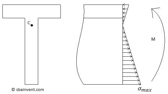

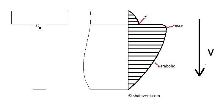

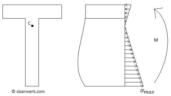

If you are doing weld design, you may need to consider the effects of shear, especially if it is combined with bending. The joint between a flange and a web is a point where shear stresses take a large jump, and this should not be neglected.
Here is a comparison of bending stress and shear stress for a typical T-section:
Left: outline of a T-section beam with point C marked at the centroid of the web. Right: a bending stress distribution diagram, with arrows increasing linearly toward sigma max at the bottom and curved moment arrow labelled M.
Bending Stress distribution
Diagram of a T-section beam with its centroid marked C, next to a shear stress distribution showing a parabolic profile across the web with the maximum at the centroid, labelled τmax, and a jump at the flange-web joint labelled τ', with load V pointing downward.
Shear Stress distribution
Just as the location of the centroid of a cross section is important in evaluating bending stress, the centroid location is often where the maximum shearing stresses are found as well.
