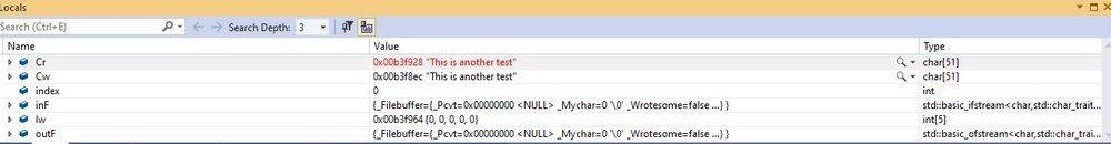

I think that if you use the debugger facility, as repeatedly suggested by @Mark44, then you will probably understand better how and why things are working as they are . . .
I start reading the debug instruction and run VS, I hit F5, nothing happen, I went to the debug menu and start debug, it just ran the program. I started the debug, then I try to set break point by putting the cursor on the line of code and hit F9, nothing happened. Basically, nothing works.
Is it when I set the break point at certain line, it will stop and display the value of the variables? The article use C# as example, I really don't follow the program.
Did I miss something to get start, seems like none of the F keys works. Can anyone advice?
Thanks

did you compile for debug, that is the first thing to check. setting a breakpoint is as easy as right clicking on rthe very left hand side of the line.

If you don't have a breakpoint set, VS will run the program and exit the debugger.
F9 toggles a breakpoint - Use F10 to single-step through a program.
If you're working on a laptop, you might have to hit another key in addition to F5 or F10, as pbuk mentioned.
Things work the same in C# or C++.
In the Debug menu, it gives all the function key shortcuts.
What I do is put a breakpoint somewhere near the start of the program, then hit F5 to execute to the breakpoint, then hit F10 to single-step from there.
I use F11 to "step into" a function if I want to see what it's doing. F10 will "step across" a function, so won't go into the body of the function.

yungman said:
But I cannot manage to get the window that show the value of the variables now. I know I've seen it before, but now I cannot make it appear. How do you bring up that window?
Debug menu --> Windows --> Locals
I stepped through the program and I can see step by step the value/string of variables. That works. My question is how do I determine whether inF.open(), outF.open() working or not? Also whether the stuffs are written into file or read back looking at the window below?
In my view that's good. The 'diagnostic techniques' set of topics constitute an eventually-advanced topic set that pretty much begins with step-by-step analysis. I recommend that you please continue with your use of the debugger tool-set.
