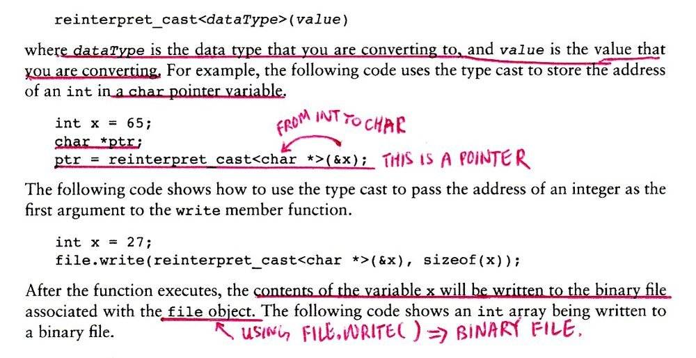

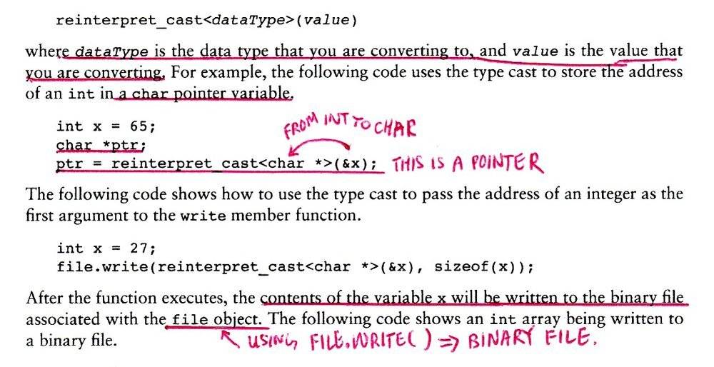

I have some question on reinterpret_cast. I marked up some notes on P678 of Gaddis book and scanned and post here. I red lined the relevant parts and wrote notes, can you guys confirm I am correct?
1) From my understanding reinterpret_cast can change from one data type to another. In the book, it show ONLY converting to char type, that's the reason the first argument is <char*>. can it be <int*> also?
2) reinterpret_cast <datatype*>(value) is a POINTER. This is according to the example in the book.
3) In the example shown, it is convert to binary file BECAUSE file.write(reinterpret-cast<char*>(&x), sizeof(x)); the .write by definition is to convert to binary file, not the reinterpret_cast.
Thanks

No, it's converting the type of &x to char *, not char. In other words it's converting &x, the address of x, which is of type int *, to a char pointer.
Yes, in the case of the scanned image you posted, but it doesn't necessarily convert to a pointer type.
No, write doesn't convert the file. Presumably the file was already opened in binary mode (ios::binary). The reinterpret_cast operator converts the type of some variable to a different type.

I kind of give up on this, the book make a big sting about file written in .txt mode and binary mode. The program in post #4 shows if I wrote and store in binary file, I can read back the EXACT same thing just reading back in text mode by using getline!
Post #16 is very similar also. I quote the page and show what exactly the book said. But there is inconsistency again.

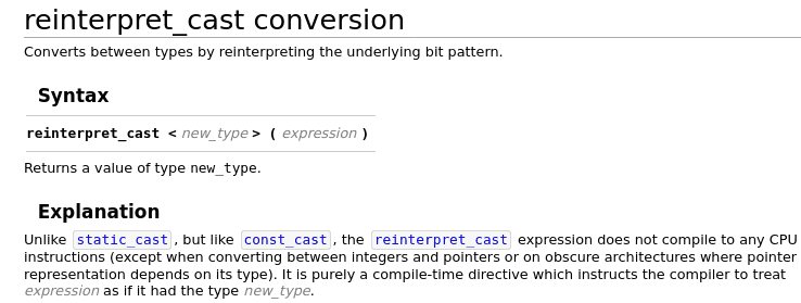

https://en.cppreference.com/w/cpp/language/reinterpret_cast
This anything BUT showing how to use reinterpret_cast. This is NOT that hard if you just read from the page of the book that I copy out, just a simple translation from one type to the other! But then it's NOT.
The two file types, text and binary, are not the same. I showed you an example in post #5 that demonstrates this. You can't use getline() to determine this, because getline() works with ordinary characters. With a binary file, there can be bytes that are not ordinary printable characters.
See my post above. You have some confusion about what the book is actually saying.

yungman said:
This is an example of looking for reinterpret_cast:
I don't know what you mean. It's a straightforward conversion from one type to another.

yungman said:
It's like in post 16, the book clearly it is transforming from integer to char. Try use that as if it's char. It doesn't work. Unless I am so totally wrong reading the few lines in the page, it has problem.
No, as I explained in my previous post. It is converting an int pointer to a char pointer.
reinterpret_cast<datatype>(value) as given in the book said as I red lined, datatype is data type you convert to, and the value is the value you are converting. This is STRAIGHT out from the page in post 16 that I red lined. So it is CONVERTING from datatype of value to datatype of <datatype>.
The give away is the line ptr=reinterpret_cast<char*>(&x) that it is a pointer of char. So according to the line above, this is converting from integer value of x to a character.
But then ptr=reinterpret_cast<char*>(&x) claim it is a pointer. For you, it's obvious because you know all these. But for someone like me that start out learning C++, I have to take it very precise and literal.
NO!
x is type int, but &x is the address of x, so its type is int * (int pointer).
The type being converted to is char *, not char.
The conversion is from an int pointer to a char pointer.
Maybe you need a stronger pair of glasses, because not noticing these details has caused you lots of confusion in all the threads you've posted that have questions about pointers.
The claim is true, for the reason above.

Mark44 said:
NO!
See, that's the problem in the book, I red lined on that page, the first line is dataType is the data type that you are converting to, and the value is the value that you are converting. You tell me.
I know for expert like you, you know exactly what's going on. But put yourself in the shoe of a student trying to learn, how deceiving can this be? One side of the mouth said it's data conversion, the other side said it's a pointer!!...in two sentences one after the other! I know they are character pointers, converting from one to another. But without finding more info, I have to assume the reinterpret_cast TRANSLATE the value to characters and put it in memory and giving back the pointer char* to point to that to be used! What else can I assume?
Then go online and search, look at articles like this:
I am sure for expert like you can understand that and it's obvious. But put it in the shoe of a student, read the 11 conditions. They might as well written in Russian. It's almost like as if their mission is to play with English so only a chosen few can understand. I already studied 700 pages of the book, more than 3/4 of the book now, but I still have NO IDEA what the article is talking. I read it like 5 or 6 times already, there are so many terms I have no idea what are they. This is NOT helping students, it's for experts and advisors like the few of you on the forum here to say " Ah, now I see!". But then you guys don't need the article!
The exact reason, book doesn't talk clearly, going on line is NOT any better. Again, for expert like you and the others here, it's very obvious. But just put yourself in the shoe of a student trying to learn. Reading online is NO better.
