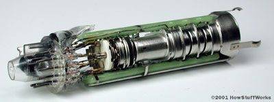

Hello!
I'm trying to make a simple ion thruster that will be used in a science fair so I'm not concerned about its efficiency but just creating at least some thrust. However I wanted to make it as close as reality as possible, using every component and respecting its details if possib
le.
Ion thrusters use 2 electron guns, and this is when I came across those electron guns used in CRTs inside old monitors and televisions. However, I don't know if they are suitable for this task. If not, are there another alternatives for the electron guns?
Thanks!
That sounds very ambitious and exciting. I hope you succeed.
Ions are much more massive than electrons. An electron gun is not an ion gun, so don't confuse the two.

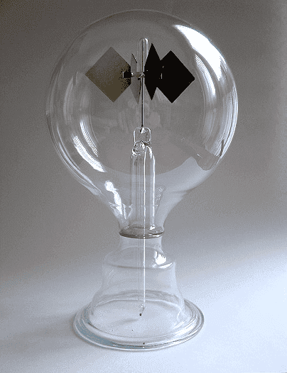

One could simulate thrusters, even build a scale model depending on the rules and education level of the science fair.
Radiometers are evacuated glass bulbs with a rotor with four vanes mounted on a spindle. Each vane has a dark absorbing side and a white or silver reflecting side.
Simulate the ion engines with a device that emits infrared (IR) and/or visible light. Not sure if CRTs are the proper device. Perhaps you could rig an IR source. A carbon rod arc-light with an IR filter certainly works but may be over-kill and requires adult supervision. Would laser pointers work?
Aim your simulated engine at the radiometer to simulate thrust by spinning the rotor.
For extra credit the OP could explain how Crookes radiometers work.
