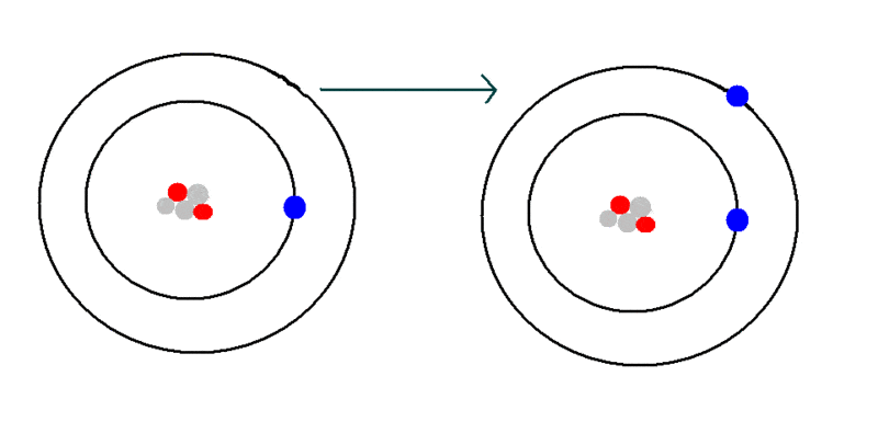

Are the electrons moving like this in conductor with current? I mean are they jumping from atom to atom (roughly said)? Why they are jumping from outer orbital to outer orbital when all outer orbitals in all of the atoms in conductor have same energy? Look the picture. Imagine that, the electron is jumping from atom to atom (infinite number of atoms). http://img87.imageshack.us/img87/5827/electrongy4.gif"
  • Two Bohr-style atom diagrams side by side with a right arrow between them: each has a nucleus of red and grey dots and two circular orbits, with one blue electron on the outer orbit at left and two blue electrons on the right atom, one on the outer orbit and one on the inner orbit's edge.
I know that people here have told you this before, but in a *conductor*, the outermost electrons are *nearly free* electrons, meaning that they are not bound to any particular atom, but are free to move about through the material. That having been said, their dynamics are affected by the presence of the periodic potential due to the nuclei. This falls into the realm of solid state physics, which is quite complicated and requires some knowledge of quantum mechanics. That having been said, there are some classical models that talk about the movement of conduction electrons (known as "drift"), and you should look them up (in books, not online!)
