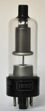

The 1B3GT Half-Wave Rectifier.

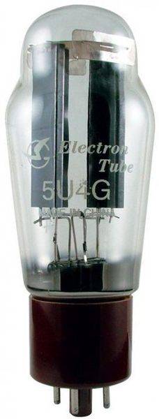

The 5U4G is a twin diode, use one or use both sections, take your pick :wink:

In this pin layout, is M connected to ground?
This is from the 1b3gt tube dlgoff posted. Which pin; if any, is that metal cylinder wired to?
Probably. It is an external electrostatic screen or metal envelope. The plate or anode is, a.
The cylindrical plate structure is connected to a small top cap, well away and isolated from the pins, marked as p on the diagram. The black bump at the bottom of the diagram is a locating index on the base socket.The slender filament heated cathode is mounted on a central axis. The tubular anode plate surrounds the cathode, so the heat due to the accelerated electrons impacting the inside of the anode, can be radiated from the larger area of the tubular anode, outwards through the glass envelope.

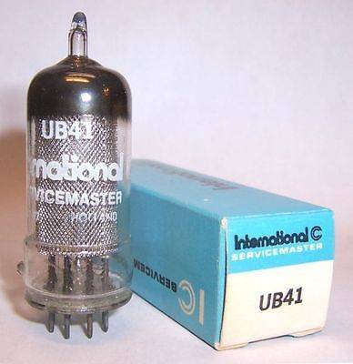

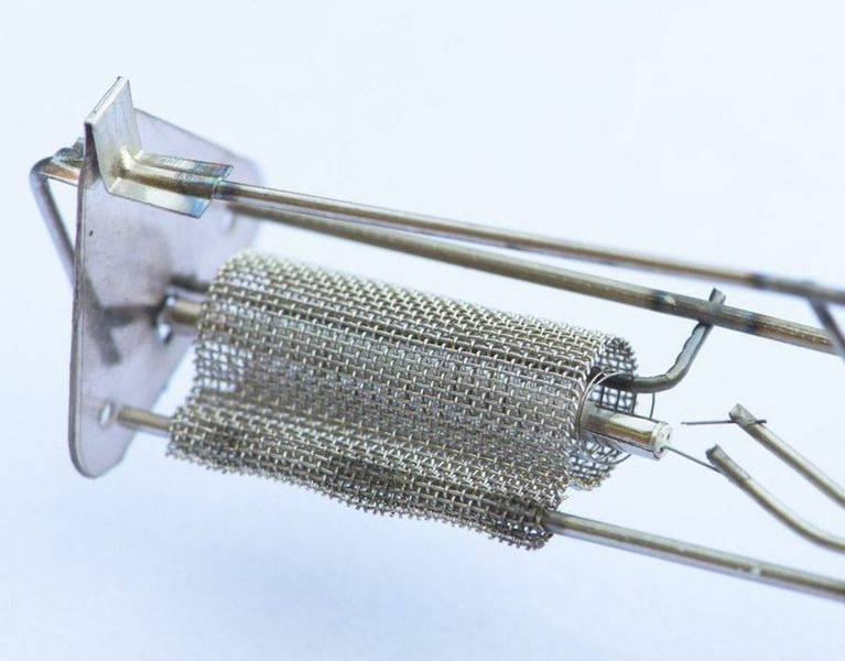

This is the tube I believe to be of use.
Notice that the pin M is connected to the mesh surrounding both anodes and cathodes. The filament requires .1 amps at 19 volts. I plan to connect pins k and d to a negative potential to accelerate emitted electrons to the inside of the mesh. In this regard, I only want to see if the mesh will act like the dome of a van de graaff.

Connect d1 and d2 to m, ground k1 and k2, heat the filament. Some electrons will be emitted from the heated k, to reach d and so drive it negative. That will repel future electron migration and so limit the voltage.
How will you use 19V to pump charge onto the capacitance of the outer mesh ?
Remember that the filaments should be operated at a similar voltage to the k voltage.
What makes the vacuum tube better than a tin can ?

The internal construction will have the two cathodes, each inside an anode tube, both surrounded by the mesh, m. The filament will be an oxide insulated tape in the form of an inverted 'W' that internally heats the thin cathode tubes. It passes up and then down each cathode tube.
I see little point in tying k1k2 and d1d2 as the electron emission from the heated k1k2 is then short circuited to d1d2. If you make k1k2d1d2 = –19V then will the filament terminals f & f will be connected to 19V and presumably 0V ?

Yes. It is the only sensible rigid construction that is capable of dissipating the anode heat. I have taken many dead vacuum tubes apart to study the construction and the internal failure mechanism that stopped them. The concentric construction seems to be universal.
Samson4 said:
Although, I still don't understand how an inner electrode can be influenced by a concentric outer cylinder.
The gap between the two is a capacitor. The environment of the inner cylinder is the outer cylinder. The outer cylinder is open at the ends so charge can pass between the inside and outside surfaces.
