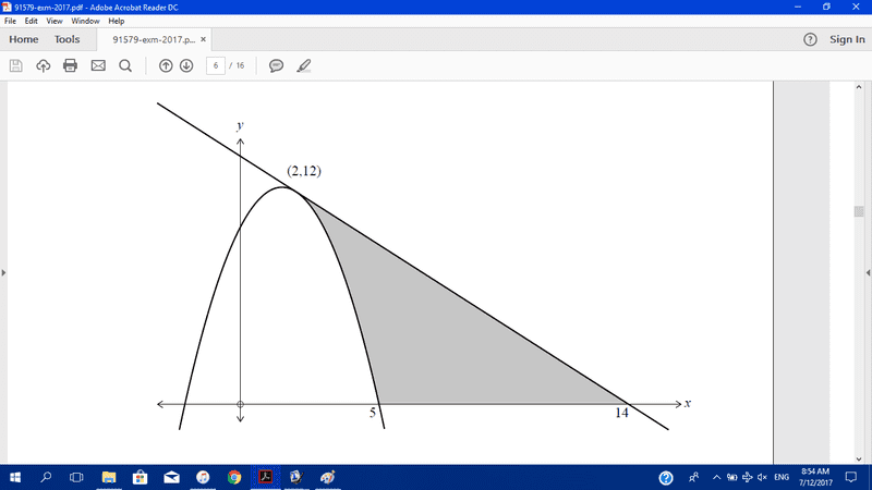

Calculate the area between ##y = -x^2+3x+10## and ##y = -x+14##. Note that ##y = -x+14## is the tangent to the curve ##y = -x^2+3x+10## at the point ##(2,12)##.
Is it as simple as calculating ##\int_{5}^{14} -x+14+x^2-3x-10 = \int_{5}^{14} x^2-4x-10##?

Anyway, your problem is not well-posed, as posted here. Is there some additional information that you left out? The area of the region between the line and the parabola is infinitely large. Did you sketch a graph?

Sorry about the confusion.
The area is between the line and the parabola and above the x axis. My bounds were ##5 \leq x \leq 14## because that's where the line and curve cut the x-axis after drawing it.

That's still an infinite area, unless there are some other bounds. The region between the parabola and the line, and above the x-axis, is in two parts -- the roughly triangular piece to the right of the point where the two figures intersect, and the part to the left of the intersection point. The portion on the left is infinite in area.
your problem statement still is underspecified. Where did the integration bounds of [5,14] come from? For instance, why not also integrate from ##(-\infty, -2)## and why not [-2,2]?

I just calculated ##\int_{2}^{15} -x+14 \; dx## and ##\int_{2}^{5} -x^2+3x-10 \; dx## then took the difference to get ##\frac{329}{6}##.

There is also the area to the left of the parabola and below the line.
Not according to the graph above.
But the graph doesn't agree with your problem statement in post #1.
The area between the line and the parabola includes the portion to the left of the parabola.
The graph implies additional restrictions that aren't given in the problem statement -- i.e., that ##x \ge 2## and ##y \ge 0##.
So which one is the problem you're working? The verbal description or the graph? They aren't the same.

The 15 in the first integral will give you a wrong answer. Was that a typo?
Sorry guys.
The question was to find the shared area in the graph & yes that was a typo.
Cheers.
Do you mean "shaded" area?
