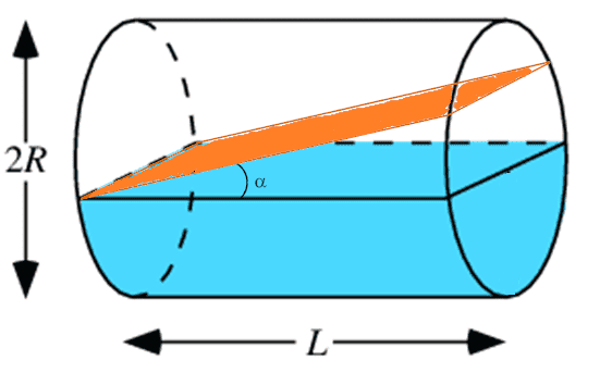

What is the equation of the area of the trapezoid when a cylinder of radius R is cut by a plane inclined at an angle α? (Orange area of the figure)
How can I relate it with Abase=π*R2 or with Ainside=2*R*L?
Any hints please?

That looks pretty straightforward unless I'm missing something. Have you taken trig yet? :smile:
Yes, I think I have but, unless I'm not grasping the whole problem, it's not quite simple.
I know that one of the sides of the trapezoid is 2R, but I don't know anything else.

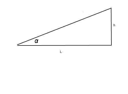

I first thought that the length of the trapezoid would be L*cosα, but I think taht L*cosα it's only the projection of the length of the trapezoid in the xy plane (the plane of the screen of the computer).
Draw a line from the center of the left end of the cylinder to the center of the chord on the right end of the cylinder. Using the angle ##\alpha## you should be able to use trig to find the vertical distance (h in the figure below) between the central axis of the cylinder to the center of the chord.
Once you know h, you can find the coordinates of the chord on the circular end of the cylinder.
I don't think the orange region is a trapezoid. If you imagine extending the cylinder in both directions, the orange slice extends into an ellipse (get a sausage, cut it on the diagonal and look at the face you expose). Reducing the cylinder back to its original length simply trims the ends off the ellipse. So the ends of the shape are straight lines, but the sides are curves. Integration may be needed.

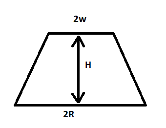

I would integrate with respect to the height of the "trapezoid," i.e. ##A = 2\int_0^H w(x) dx ## where H is the total height of the shape and w is the half-width of the "trapezoid".
If you can get it into the form of
## A = m\int_0^H \sqrt{c^2 - x^2} dx ##
then the integral evaluates to:
##\frac m 2 \left( H \sqrt {c^2 -H^2}+c^2 \sin^{-1} ( H/c ) \right) ##
I had to look that one up, so maybe it'll save you some time.

My interpretation of this problem, which could be wrong, is that the diameter at the left end of the cylinder and the chord at the right end, define a trapezoid. In my interpretation, it's immaterial whether the nonparallel sides of the trapezoid are inside the cylinder or outside it.
The problem is somewhat ambiguous. The OP originally had "Area of ellipse..." in the title, but in post 1, asked about the area of the trapezoid. I changed the thread title to be consistent with the question in post 1.
berkeman said:
Can you give us some context to this question? Is it for a real-world application, or just a curiosity? Or is it for schoolwork? Thanks.
Yes, of course. It's a model for a real-world application.
Imagine a magnetic flux (or any type of flux, for that matter) that passes through that cylinder.
If the cylinder's axis is parallel to the x-axis and parallel to the magnetic flux vector, the area crossed by the flux is the Abase=π*R2, and the length of the path of the magnetic flux is L. On the other hand, if the magnetic flux vector is orthogonal to the cylinder, the area crossed by the flux is Ainside=2*R*L and the length of the path of the magnetic flux is 2*R, it's diameter.
Now, when the cylinder is inclined with an angle α to the x axis, the magnetic flux through the cylinder must be decomposed in two parts:
-one is the projection of the cylinder in the x axis, where the area crossed by the flux is the area of an ellipse (Abase/cos(α) and the length of the path of the magnetic flux is L*cos(α);
-the other is the projection of the cylinder in the y-axis (orthogonal) where the area crossed by the flux is in my opinion the area of the trapezoid that I want to find (and that I need/I think to have a sin(α) in the expression) and the length of the path of the magnetic flux is L*sin(α);

I'm sorry but I don't understand. When you consider w the half-width of the trapezoid, are you referring to the length of the base of the trapezoid? In this case which base? The minor or the major?
In my breakdown of it, I was calling w the half-width of the short side of the trapezoid.
I see and agree.
In that case my only last question is what is c.

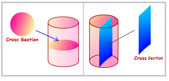

Would both of you care to explain, exactly how is the section of the cylinder relevant when you're actually tilting the cylinder itself ?
Imagine slicing the tilted cylinder from one base to another. That's how the flux "see/crosses" the cylinder when it is tilted.
?? As lbix pointed out. The plane figure is not a trapezoid but a truncated ellipse. ??
---Unless it's the trapezoid contained within the truncated ellipse that is of interest.

c is a constant for the formula, just like m. When I worked it out, it ended up being some combination of initial parameters R and sin(alpha).

In my opinion it is not. It's a trapezoid because a flux would cross all the length of the cylinder.
Here is my attempt at explaining why the cut-section won't be a trapezium:-
When the cutting plane is horizontal the section is obviously a circle.
When the plane is vertical the section is again obviously a rectangle.
Now imagine we start with a plane that is completely horizontal (lowermost cut) and slowly tilt it until it becomes completely vertical. At first you will get ellipses (upper 2 cuts)
Now if we keep tilting the cutting plane, at one point it will cut one of the bases of the cylinder as well and one curvy end of the ellipse is as ibix says "trimmed off", even more tilting, and the cutting plane will cut both of the bases, as in the original picture, and both the ends will be trimmed off, however the other two sides still remain curved, and they will continue to remain curved until the cutting plane is completely perpendicular. The only difference is, is that as you keep tilting the cutting plane their curve is becoming less and less apparent.
P.S. I still can't see what all this has to do with your original problem.

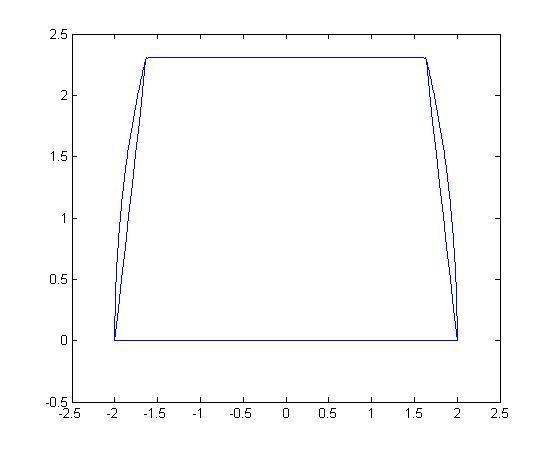

Above is a quick plot of the trapezoid cut from a cylinder using R = 2, L =2, alpha = 30 degrees. The outer lines represent the actual width of the cylinder along the path, while the inner lines represent the straight trapezoid.
Once you work out the required trig to find the proper values of your variables, this either reduces to a simple expression (trapezoid), or the integral I posted above (truncated ellipse).
You can draw right triangles everywhere to find the right values based on R, L, and alpha.

This is awesome. Have you done it in Matlab?
Would you be so kind to lend me the code you've used?
Here is the code I used in Matlab. It is not elegant, but does the trick.
r = 2;
alp = pi/6;
L =2;
H = 2/cos(alp); %length of trapezoid
h = 2*tan(alp); %height from middle at opposing side
w = sqrt(r^2 - h^2); %half-width at opposing side
x = linspace(-r,r);
y = zeros(size(x));
for i = 1:length(x)
if x(i) < -w %left edge
y(i) = H/(r-w)*(x(i)+2);
elseif and(x(i)>= -w, x(i) <= w) %top
y(i) = H;
else
y(i) = -H/(r-w)*(x(i)-2); %right edge
end
end
end
y2 = linspace(0,H);
wplus = sqrt(r^2-y2.^2*sin(alp)^2);
wmin = - wplus;
plot(x,y) %trapezoid
hold on
plot([-r,r],[0,0]) %bottom line
plot(wplus,y2) %right side cylinder
