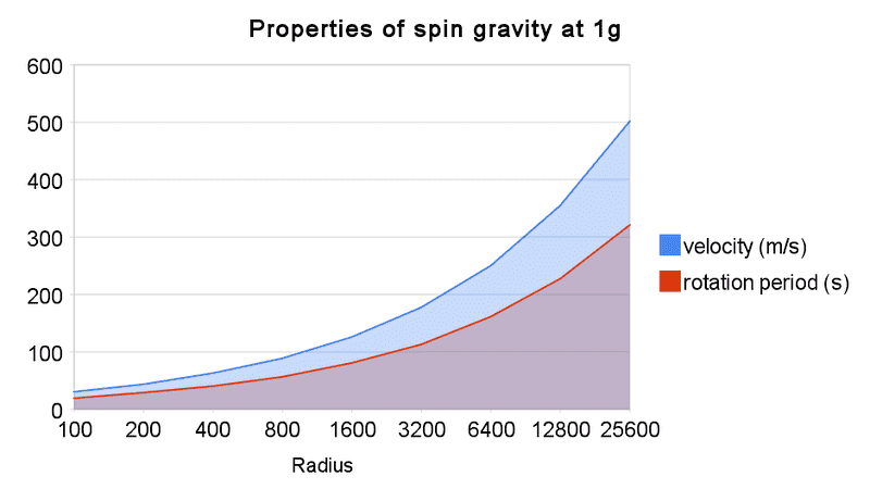

Ok, well how fast would the station have to be rotating to produce 1G? I'm sure you could make a space station small enough to generate 1G with relatively low speed. In that case, you could lose lots of weight by running antispinward but how would you propel yourself once you leave the ground?
Other way around.
For 1G, slow speed requires a big station. You want a small station, speed must be high.
DaveC426913 said:
Other way around.
Why are the speeds actually even different? Isn't the G-force just a product of the momentum of the objects inside the station. So shouldn't any object move with 1G of force if it is accelerating at a given rate?

The object is not accelerating. The object is traveling in a straight line (tangential to the space station's rim). It is the space station that curves up toward the object. It is this floor-coming-toward-object that is (mis)interpreted as an apparent force pulling the object toward the floor.

Here're some numbers:

The force is proportional to the radius and to the square of angular velocity, but tangential velocity is directly proportional to both. If you quadruple the radius, you must halve the rotation rate, which still gives you double the linear velocity. Larger stations require lower rotation rates, but higher tangential velocities. (As the radius of curvature increases, the speed along that curve must increase to maintain the same acceleration.) And in this case, it seems to be that tangential velocity that's of interest, not the rotation rate.
Ah right. That's why it threw me. One goes up, the other down.
Large stations are preferred because, ideally, you want the rotation rate as low as possible (less disorientation, less Coriolis Effects, etc) but you do end up with a higher tangential velocity (though the everyday occupants don't concern themselves much about that.)

Does this mean that a very large space station could rotate very slowly to generate 1G of AG? Would that mean that weightlessness would be achieved with relatively little antispinward acceleration? That seems counterintuitive somehow, but only because I can't imagine my weight increasing or decreasing drastically due to small variations in speed.
No. It would complete one revolution in a long time, but its actual tangential velocity would be quite high.
(Being in a rotating space station is kind of like climbing a slope curving upward but never reaching the top. A big space station is like climbing a long, gentle slope very fast, whereas a small SS is like climbing a short steep slope much slower. Not sure if that helps.).
See, the bigger the station, the more it emulates a real planet. That's why we would prefer one. It also means all the cool effects go away. You end up having to have normal airplanes instead of gossamer wings.

Ok, according the following calculator a space station of radius 10m rotating at 22mph would generate almost 1G of AG.
http://www.calctool.org/CALC/phys/Newtonian/centrifugal
At 11mph the AG seems to go down to @0.25G. So how would you maintain traction as you accelerate all the way to 22mph? It seems like you would be moon-jumping by the time you reached 11mph.
