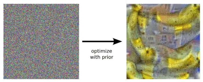

I can't get over how cool/creepy this is. Researchers took image recognition neural networks and asked them to look for certain images in random noise and once identified modify the image to highlight the pattern. That new image is fed back into the machine and it's asked to do the same again. After multiple repetitions the pictures are bizarre, beautiful or both.
I see what you mean ( by most of the images ). I would not call it "pattern recognition" but rather a LSD-trip.
But I think you know, that "real" pattern recognition uses mathematical rigid methods like Fourier-transforms, Hough-transforms, lens correcting functions, amongst other methods, to measure what is going on in an industrial production ?
What makes it not pattern recognition? It's not necessarily good pattern recognition initially given that the machine is detecting patterns that aren't there but after it has edited them in slightly subsequent tests detect that patter.

we just start with an existing image and give it to our neural net. We ask the network: “Whatever you see there, I want more of it!” This creates a feedback loop: if a cloud looks a little bit like a bird, the network will make it look more like a bird. This in turn will make the network recognize the bird even more strongly on the next pass and so forth, until a highly detailed bird appears, seemingly out of nowhere.
What intrigues me about these images is that they could be used to illustrate similar human psychological and neurological flaws, from confirmation bias, through delusion and pareidolia, all the way to hallucination. In fact, I wonder if the exact same kind of feedback loop isn't at work in all those things.
