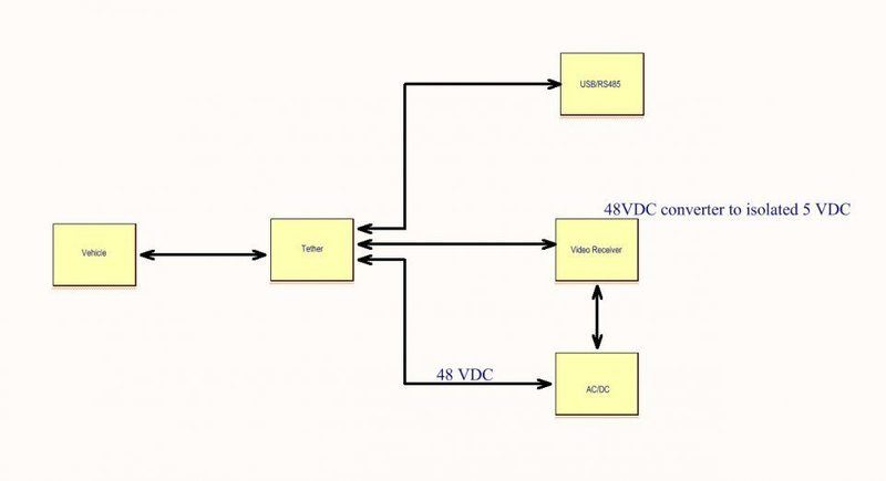

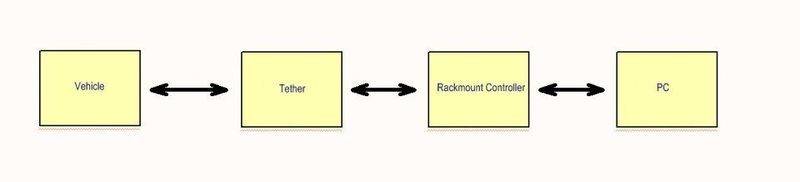

I am not sure how to attach images so I made a dropbox account. There is a vehicle which has a tether attached that carries the power, video, and communications. The tether will plug into a rackmount controller (this is what I usually design) which then connects to a PC to use our control software. The vehicle would be a whole separate EMC issue so I just want to focus on the top-end for now.
System overview: https://www.dropbox.com/s/32wnh1dvwhlw7yw/system_overview.jpg?dl=0
I have another image of what is typically inside of our controller.
From what I have seen around here the isolation needs to have separate ground and power rails. The amount of isolation doesn't really seem to matter, most things here are 1.5 kV of isolation. If we do not isolate the video circuitry power from the communication power (we use RS485) we will see comms noise on the video.
We will create the RS485 by using an USB to RS485 converter. We have seen problems when this does not have isolation. Depending on the PC the customer has it can create a lot of noise so now we just always isolate this. We will either create an USB to RS485 circuit or use an off-the-shelf converter, I usually pick the off-the-shelf stuff when I can so I would say 80% of our controller will use an EasySync or something similar.
As for the DC/DC converters we generally use isolated topology and the switching frequency varies. Depending on the converter they seem to range from 250 kHz - 750 kHz.
I have another dropbox link showing a block diagram of what is typically inside of a rackmount controller.
From that diagram we will have an AC/DC converter which will create 48 VDC and send that down to the vehicle, when it gets to the vehicle it gets stepped down again. The AC/DC converter will be an off-the-shelf power supply which will have isolation.
The 48 VDC will also get send to our video receiver circuit which will step it down to 5 VDC. This will be done using an isolated topology.
The USB to RS485 is powered from the USB port from the computer, also an isolated converter.
All these will have external cabling leaving the controller.
Controller overview: https://www.dropbox.com/s/32wnh1dvwhlw7yw/system_overview.jpg?dl=0
So when I got to the part of the EMC course where they tell me to ground signal common to the chassis, as well as AC Earth to the chassis, I was confused on how to apply that to my situation, maybe I can't.
My concerns for shielding are the tether attaching to this controller, the video cables, the usb cables and the AC cables.
If the pictures don't work or you need more info please let me know.
Thanks for the help!

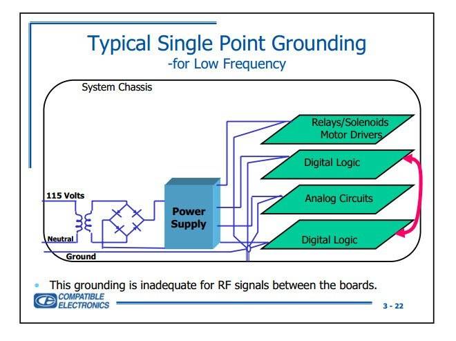

Your questions are good. EMC isn't really a "black art" when you learn how to think about it. First, DC-connected RS-485 is not a good choice for comms in a noisy environment. If you are using the transformer-isolated version, then it's probably okay. Otherwise I'd encourage you to look at transformer-isolated alternatives for comms.
Next, one of the most important concepts in electrical isolation and noise isolation is "shared impedance". Let's say that you have two circuit blocks that share some ground impedance. That is, they have connected grounds that have some shared trace length back to the power supply. Then what you get is the transient currents in the ground of one of the systems causes transient voltages in the other system, because they share some impedance back to the power source. That's generally a bad thing. Instead, when you connect/share grounds, the connection should be in the form of a "star ground", where all of the ground connections are short and wide and right back to the power source.
A good example of this is a microcontroller (uC) and a radio chip/module on the same PCB. The uC communicates with the radio chip via some serial interface for communication, but you need to keep the digital noise of the uC out of the radio system in order to achieve the best receive sensitivity. So it would be a design error to run your power and ground connections from the power supply past the uC and to the radio chip. The uC's transient power and ground currents would induce noise voltages in the radio chip that would seriously impact its receive sensitivity. (Don't ask me how I know this...) :smile:
Instead, you use a star power distribution and grounding system in this case. You put the final voltage regulators in the middle between the uC and radio chip/module, so that their individual transient currents do not cause transient voltages in each other's power rails. Very important.
Also, keep in mind that even if you have galvanic isolation between circuit blocks via transformer-isolated DC-DC converters, you still have capacitive coupling between those blocks. Depending on the frequencies of interference involved, you may need to use some extra techniques (like shield layers in the transformers) to cut down on that noise coupling.

Thanks for the reply. I think I am starting to get it a bit more. I have uploaded the images to this post now. I have attached another image I found online of a single point grounding scheme, it is not from the EMC course I am taking. I think it shows pretty much what I am trying to do.
I can see how this grounding scheme would be better for EMC because there will be no shared impedance as you mentioned. Where the grounding pictures differs from what I typically do is we use an isolated power supply and, depending on the PCB, some of the circuits and logic will be isolated from each other.
If I require this isolation, I wouldn't want to use this type of grounding correct? Or, because there is capacitive coupling between the input and output of the converter anyways, does it even matter?
