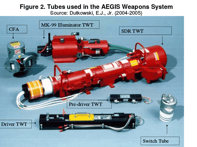

We used 'twits' in the electronic warfare and jamming equipment I worked on.
http://en.wikipedia.org/wiki/AN/SLQ-32_Electronic_Warfare_Suite
This is one area where tubes might still be 'supreme'. :devil:
Even the new gear still uses tubes.
  • Labeled photo of AEGIS weapons system tubes on a blue background: red MK-99 Illuminator TWT, SDR TWT, large red TWT body, CFA, pre-driver TWT, driver TWT, and a switch tube.
Damn. You really are a spook. Awesome. :thumbs:

The TWT type tubes are unique in their ability to generate high power across a wide band of radar frequencies and when designed as a LNA, provide a very low noise amplification front-end for receivers that made them perfect for a wide-band radar detector that's also resistant to EMP. They are still being used in communication satellite transponders today.
http://www.r-type.org/articles/art-030.htm
http://www3.alcatel-lucent.com/bstj/vol42-1963/articles/bstj42-4-1703.pdf
