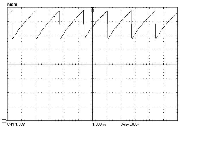

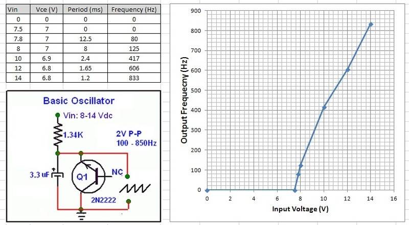

I hooked up a small circuit I found towards the bottom of this url and plotted the result in a spreadsheet (figure 1). Figure 2 shows the DC-coupled output waveform at 12V input. Only the frequency changes at different input voltages.
So what's going on here?
Figure 1:
Figure 2:
Hint 1: Relaxation oscillator

EDIT - To avoid confusion: The Vce voltage from the table in Figure 1 is the 'DC' voltage measured with a multimeter.

It's the breakdown behaviour of bipolar transistors when the base is open. This voltage shows a hysteresis, because it take a minimum "base" current to have a current gain that reduces the breakdown voltage.
Many things are reverse polarized in your diagram. The capacitor can't be intentional. The transistor is probably intentional, in order to use the smaller base-emitter breakdown voltage. Though, as the reverse current gain is smaller, so is the hysteresis.
In real life, this would be more difficult to observe. I suspect the simulator introduces some "software" hysteresis by "deciding" if the junction avalanches.

It was a real circuit, not simulated, but apart from that Enthalpy's explanation is spot on. Well that is to say, it agrees entirely with my interpretation of the circuit. :smile:
A BJT will work with emitter-collector interchanged, but typically with very much reduced current gain and very much reduced breakdown voltage.

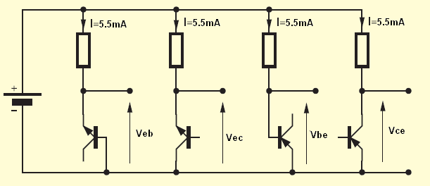

Long time ago I measure reverse-bias voltage from emitter to base and emitter to collector in general purpose BJT
For PNP
BC556
Vbe=10V; Uce=10.65V
BD140
Ube=12.55V ; Uce=13.02V
And for NPN
BC337-40
Veb=8.2V; Vec=6.7V; I=5.5mA
BC549B
Veb=8.3V; Vec=7.2V; I=5.5mA
BD139-16
Veb=8.5V; Vec=6.7V; I=5.5mA
BC639
Vbe=7.7V; Vec=6.3V; I=500uA
BC337
Veb=7.9V; Vec=6,4V; I=500uA
2SC945
Veb=8.1V; Vec=7,5V; I=500uA
As you can see for NPN BJT's the Vec voltage is smaller than Veb breakdown voltage.
