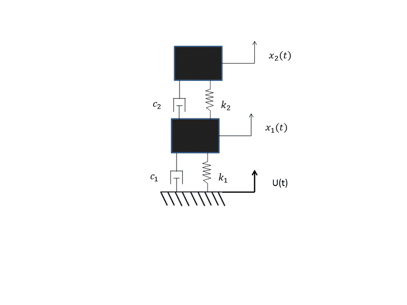

I'm trying to derive the equations of motion and state space as well as the transfer function for a system which has two mass spring damper systems stacked on top of each other. The system is base excited. I attached a pic of the system
Schematic of a two-degree-of-freedom base-excited system: two stacked masses, each with a parallel spring and damper, labelled k1, c1, k2, c2, displacements x1(t) and x2(t), and base input U(t) on a grounded support.
- Sum of the forces as per usual
- The transfer function is defined as H(s)=X(s)/U(s)
Two coupled equations of motion for a two-mass system: m1x1'' = -k1(x1 - u) - c1(x1' - u') + k2(x2 - x1) + c2(x2' - x1'), and m2x2'' = -k2(x2 - x1) - c2(x2' - x1').

Your equations look right. You can solve by the usual diff. eq. methods.
