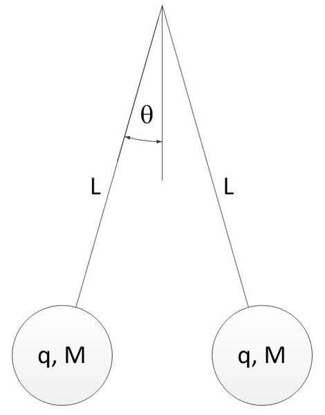

For the system given, both objects have the same charge and same mass (both given). I'm also given string length, L. I need to solve for θ.
Coulomb's Law, W=mg
Using simple equilibrium force analysis (with weight, tension, and electrostatics forces), I get:
Is there a way to solve for θ analytically, or do I have to find a graphical solution?
Thank you!
It might be manipulated into the form of a cubic equation. Cubics have a closed form solution for their roots. It'll involve a couple of changes of variables I think. Try expressing cos(θ) in terms of sin(θ), and then call x = sin(θ) so you're working with x rather than trig.

The equation ##\sin^3(\theta)/\cos(\theta) = a## is not difficult to solve analytically. For ##a > 0## we have ##0 < \theta < \pi/2##, so ##\cos(\theta) = \sqrt{1 - \sin^2(\theta)} > 0##. Therefore, the new variable ##x = \sin^2(\theta)## obeys the cubic equation ##x^3/(1-x) = a^2##. The exact solution of this cubic is not too complicated or difficult to work with. From ##x## we can recover ##\theta = \arcsin(\sqrt{x})##.

I believe this is incorrect. I'm pretty sure of the solution I posted, since it does agree with computational results.
Thank you so much!
I went down this path and saw the enormously complexity of solving cubics, which is - I guess - why we're taught to use graphical solutions methods instead.
