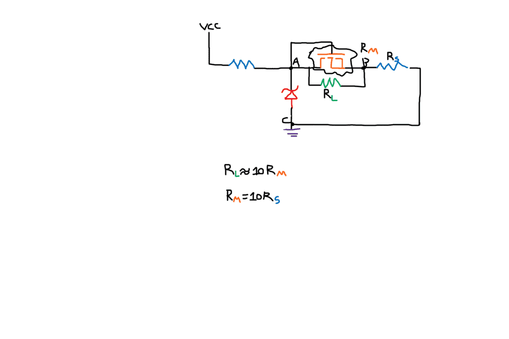

I have been trying for a long time to build a costant current source which I know is impossible to keep the current exactly the same but as much as possible. This is what I have done so far:
Hand-drawn schematic of a current source: VCC feeds a blue resistor to node A, a red Zener diode runs from A to ground C, a MOSFET symbol (orange) sits between A and B, and resistors RS (blue) and RL (green) connect at B. Below are the notes RL ≈ 10 RM and RM = 10 RS.
The operation is very simple . If VCC is increased the VAC is increased a little bit. When VA is increased a little bit Rm is reduced a little bit and VB is increased a little bit-> current through RL remains more costant.I am using the phrases 'a little bit'because I can't calculate . Any help really appreciated.
There are many ways. What range of current; 1mA to 1 amp ?
What compliance, or supply voltage ?
How are you going with LTspice ?
I have download LTSpice but I don't know how to rotate things to set the opposite polarity of the zener diode.

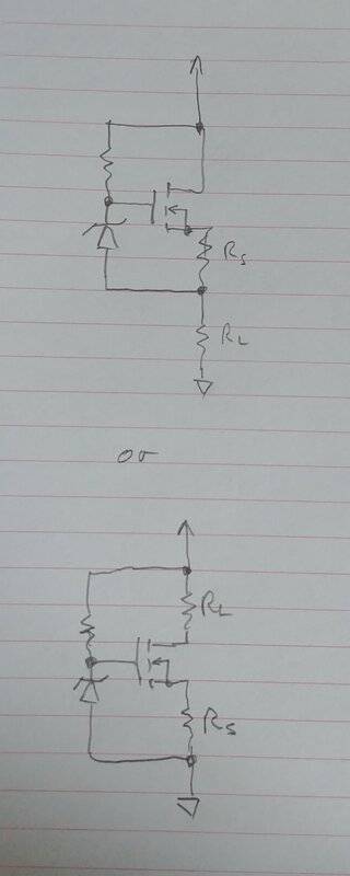

Here's a couple of more standard variations for loads ground or high side referenced loads.

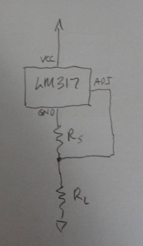

Also, a version of these that I used many times in industry with a linear regulator. This could be for either a high or ground referenced load. The IC version won't work well for low currents, because of the bias currents that have to flow through to IC. But it is small, cheap, and rugged.
Two hand-drawn schematics on lined paper separated by the word 'or': top shows an NMOS with a Zener diode and resistors Rs and RL, with load to ground; bottom shows a similar NMOS-Zener circuit with RL at the top and Rs to ground.
Hand-drawn schematic of an LM317 regulator with VCC input, ADJ connected through a resistor R_S to a node, and a load resistor R_L to ground; the OUT pin labelled GND.
edit: Oops! Typo in the LM317 circuit. The terminal I labeled "GND" should be "OUT".

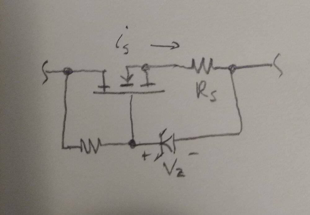

The key point in all of these configurations is the portion shown below. The transistor is biased on with the drain-gate resistor. When the voltage drop across the zener reaches Vz, then the gate bias is diverted and the transistor starts to regulate the current in it's linear operating region. So when the voltage Vg(th) + Is⋅Rs = Vz the circuit is controlling the current to stay at the equilibrium value Is = (Vz - Vg(th))/Rs. You'll see variations of this circuit inserted in many configurations: high side, low side, different transistor types, and different polarities. But the basic concept is the same.
Hand-drawn schematic of an NMOS current source: a MOSFET with its drain-gate resistor, source current i_s flowing through series resistor R_s, and a Zener diode V_z in the gate branch.
edit: You can also think of this as a voltage regulator circuit if the load is Rs. Although, it's a pretty crummy one, for a bunch of reasons. As a current regulator, it isn't as accurate as the versions that use linear ICs (op-amps, etc.) since the voltage Vg(th) (or Vbe for BJTs) isn't very well controlled. For a DIY current source I also like the LM10 IC. It's an ancient chip with a low voltage reference (0.2V) and an op-amp. One of the problems with the others is that they drop a lot of voltage, which is fine if you have that much available.
Don't you want to bias the MOSFET so that it is saturated? This way Ids is a function of Vgs and not Vds [1], and since Vgs is constant Ids is constant, hence a constant current source.
[1] I assume we can ignore the various non-idealities like channel length modulation.
Not if I could control the transistor in it's linear region with better sensors, references and amplifiers external to the MOSFET. Yes, FETs can act like current sources. But we can do better with a current sensing resistor, a reference, and an op-amp. IC amplifiers are ubiquitous and cheap, which allows more of a systems level design approach. Outside of learning about device design/operation, in the real world, analog stuff is nearly always done with many transistors integrated in an IC. A device like the LM317 includes a good reference, a "good enough" amplifier and a power transistor with protection circuits, all in one device which costs about $0.50. If you can spend $4-$5 you'll want something like an LT3092 IC.
Even in the simple mosfet & zener circuit, I suspect that Vgs(th) is a more stable device characteristic than the saturated channel current source, although I haven't (maybe ever) looked into that. If you didn't want a sense resistor and a zener, then yes, a saturated FET channel would be a way to (sort of) get the job done, but how would you set the current value? Channel dimensions? Doping levels?
When I wrote that I was thinking if one looked at the norton equivalent circuit then it would have a higher output impedance if the FET was saturated and this could be done with one more resistor. But now that I'm looking at it closer there's not much point to doing that because as long as the zener takes a small enough current one get actually get a pretty tight regulation from this topology. I suppose I should've known that because the feedback loop around the source resistor is a fairly common technique.
