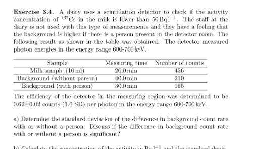

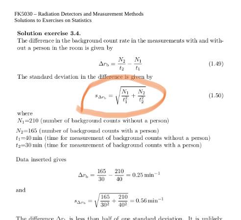

I don’t get how they got the equation for the standard deviation. Why do they only square with the time in the denominator?
Thanks!
Printed exercise 3.4 on a scintillation detector measuring 137Cs activity in milk, with a table of sample and background counts over measuring times and the detector efficiency statement.
Printed solutions page for radiation detector statistics exercise 3.4, showing equation 1.49 for the background count rate difference and equation 1.50 for its standard deviation, the latter circled in orange, with substituted values N1=210, N2=165, t1=40 min, t2=30 min and results 0.25 and 0.56 per minute.
We know that the SD of the total number of counts n is √n and rate r =n/t
So;
n=rt
Δn = (Δr)⋅t =√(n/t)t
Δr=√(n)/t =√(n/t2)

Aha! Thanks!
