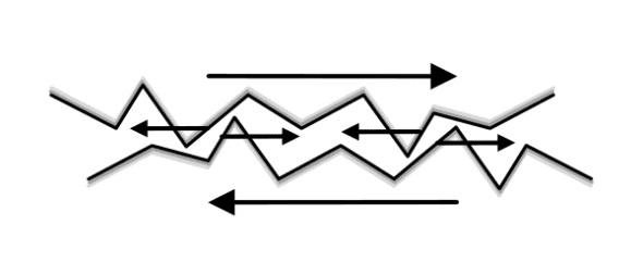

This is not necessarily a homework problem, as I am not in the course yet, but could someone please explain to me about the basics of friction
Sure, it's a pretty simple concept. To understand friction, you need to understand something called the "normal force" Imagine you are standing on a floor, obviously, gravity from the Earth is pulling down on you, but why aren't you accelerating? Because the floor provides a counter force to hold you in place. Similarly, imagine you put your hands on a wall and push on it, neither the wall nor you move anywhere because the wall provides enough counter force to hold you back. This kind of reactionary force that acts parallel to a surface is called the "normal force" and the strength of this force is one of the important factors in determining the strength of frictional forces. All real surfaces are not perfectly smooth, but instead have many irregularities on a visible or at least microscopic level. This means that any two surfaces sliding against each other will not slide perfectly smoothly, and will in fact apply a force on this other. On a microscopic level, this interaction might look something like this:
This is the cause of the frictional force, it always acts in opposite direction as motion (as to provide a reactionary force as called for in Newton's third law, and the formula for finding the strength of this force is as follows:
