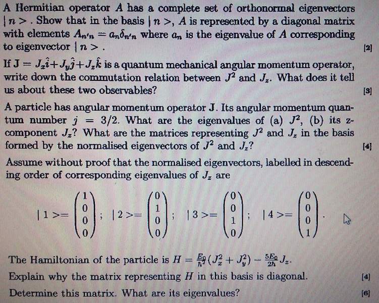

The last 2 parts of the attached photo. (4 and 6 marks)
Im really not sure how to go about them in a (clever) way that won't take 2 hours.

For the explanation you could say that any operator represented in terms of its basis states is diagonal - but then how can you tell that those four given eigenvectors are the basis states of H? (you're only told that they are eigenvectors of Jz).
The eigenvalues are the enegry eigenvalues (along the diagonal), but to find the matrix (knowing its diagonal) you can just find <1|H|1>, <2|H|2>, <3|H|3> and <4|H|4>. But you need some sort of matrix or equation for the J2x + J2y part of the Hamiltonian - its possible to find their matrices in this basis but I just can't believe there isn't an easier way for 6 marks...
Did you compute [tex][J^2,J_z][/tex] for part 2? What does it tell you about the eigenvectors for [tex]J^2[/tex] and [tex]J_z[/tex]?
Can you write [tex]J_x^2 +J_y^2[/tex] in terms of [tex]J^2[/tex] and [tex]J_z[/tex]?
Hi, thanks so much for your help!
Yes, their commutator is zero, so they commute and it is possible to find simultaneous eigenfunctions of both of them.
I think [tex]J^2 - J_z^2[/tex] should do it?
Since (given your first tip) an eigenfunction of [tex]J_z[/tex] is simultaneously an eigenfunction of [tex]J^2[/tex], would rewriting the Hamiltonian using this show that it is expressable in terms of the given four basis states? - and therefore is diagonal?
And then I guess to find the Hamiltonian's (diagonal) matrix elements you can now just use the previously calculated matrices for [tex]J^2[/tex] and [tex]J_z[/tex]?
That would seems a lot more sensible than what I attempted...
Yes, just compute a bit and you'll find that things are as you say. It's hard to get all of this straight just from lectures, so it's exercises like this that really teach you how things work.
