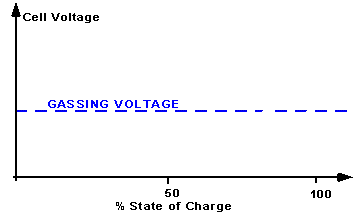

Observe once again
http://www.powerstream.com/SLA.htm
the gassing voltage drops to 2.3 volts per cell at 50C, which is well below the normal charging voltage at 25C. i only presume it continues to drop as temperature rises. So the smart charger needs to know the temperature of the battery , for an overheated battery looks to it just like an undercharged one, and obedient little robot that it is it'll keep on trying to bring voltage up.
