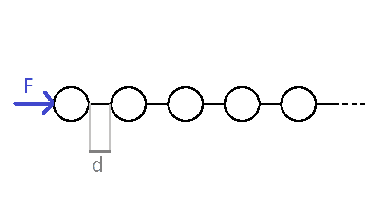

Hello!
I would like to ask for your help with understanding a few things connected to the following problem:
1. Homework Statement
There is an (infinitly) long thread, on which small beads can move without friction. The beads with mass m are lined up on the thread with a constant distance d between them. Whe start to push one bead with the constant force F and continue to do so all the time. The velocity will eventually reach a final, constant value. What is this value of the collisions between the beads are completely inelastic?
F * Δt = Δp
v * Δt = Δs
3. The solution
When the first bead is accelerated, it will collide into the next one. The beads stuck together and collide in the third one, then the fourth one and so on. If the final velocity is v, the number of new beads attached to the moving "chain" in a time Δt is: n = s/d = v*Δt/d
Therefore the change in mass of the moving "chain" is: Δm = m*n = m*v*Δt/d
Because the velocity is now constant, the change in momentum is only due to the change in mass:
F*Δt = Δp = v*Δm = v2*m*Δt/d
Thus: v = (F*d/m)^(1/2)
Now, there is nothing wrong with the solution. The thing I don't understant is exactly why a constant final velocity is reached. I know that when the total mass approaches infinity, the acceleration will become zero (a=F/m), but is there anything else which causes the acceleration to stop? I feel like the condiction of infinit number of beads is not directly included in the solution. I do therefore wonder: Is there any outer force which counteracts the pushing force F?
I have also thught about an energy aspect. In this case, the work done by F on a distance d should equal the kinetic energy of a new bead, shouldn't it? However, this yields: v = (2F*d/m)^(1/2) , which is one factor √2 to much compared to the answer obtained in the solution above. Why?
Thank you very much!

Nope. The beads that are moving already are not accelerated further. every ##\Delta p## involves only one extra bead !
Last question: energy is lost because the collisions are inelastic.

We could treat this as a smooth process, but it might be clearer if we treat it as discrete.
Suppose we have just picked up the Nth bead and they're all moving at speed vN. What will the speed be after picking up the next bead?

You are told the collisions are completely inelastic. What is conserved?
F dt = M dV + V dM
Consider a glob of putty thrown at a "fixed" wall and sticking to the wall..
Then the impulse on the wall is F dt = V dM because the wall does not move.
Then you get the term V^2 = F d / M where M = L m / d since dM / dt = m V / d.
So the accumulated beads behave as a fixed wall which is being moved by a force F.
Also, this holds at all times after t = 0, and the impulse as each bead is added continually corresponds to the force F.
So one could accumulate an unlimited mass of beads with the application of force F at speed V.

No, you've forgotten about the force. The velocity will increase before it strikes the next bead.
Now, there is a much easier way, but I went this route because you asked how we know it will converge to a finite speed.
If you assume a steady state is reached, you can work in the reference frame of the moving mass. The force F applied one side is to be balanced by the steady stream of impacts from beads on the other side. You can just write down the solution.
