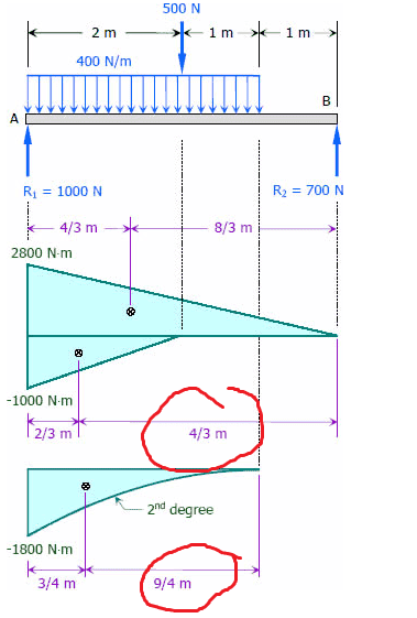

from the link , why the distance of centroid from B is (4/3) and (9/4) as shown?
it should be (4- (2/3) ) and (4-0.75) , am i right ?

For the right triangle, the centroid is located 1/3 the base from the right angle or 2/3 the base from the acute angle.
For the second degree curve, the centroid is also shown correctly.

but , the problem is (area AB) x B , so the location should be measured from B , am i right ?
Beats me. The locations of the centroids shown are correct.

ok, for Parabolic spandrel , the centroid is 3a/4 , so it's 3(3)/4, but, it'should be measured from B, am i right?
So is it 1 +9/4 = 13/4 ?

If you want to measure it from B, sure.
But the location as shown in the OP is also correct, since the spandrel starts 1 m away from B.

sorry, it's my fault, then for the smaller triangle part , it should be -0.5(2)(1000)( (4/3) +2 ) , is it true?
Why the author left out +2 ?
(area AB) x B means area x distance of centroid measured from B,am i right?

For the smaller triangle, the centroid location measured from A is correct, but the location measured from B is off by 2 m. The 4/3 m should actually be measured from the tip of this triangle.
