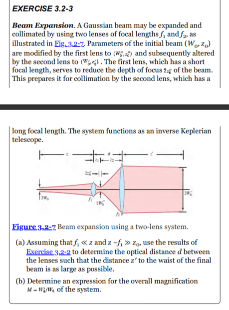

Determine the optical distance d between the lenses such that the distance z′ to the waist of the final beam is as large as possible.
Gaussian beam
Basically this is the Exercise In Fundamentals of Photonics book.
We also need to use these two equation (1) and (2)
