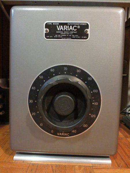

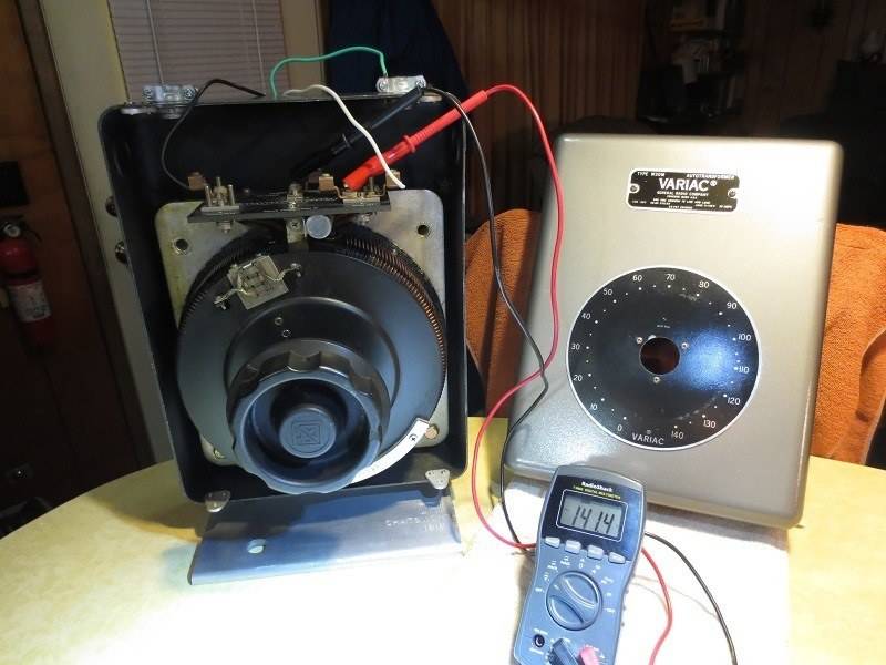

I've been trying to get a metal deposition system put together but had to do a little beautification on this old General Radio Co. W30M Variac that I'm incorporating.
To get the current to heat the Tungsten evaporation element, like this circuit in the old Variac's manual,
I picked up this (after two days of cleaning) beauty, "supplementary transformer" (actually 0 to 5 vac power supply).

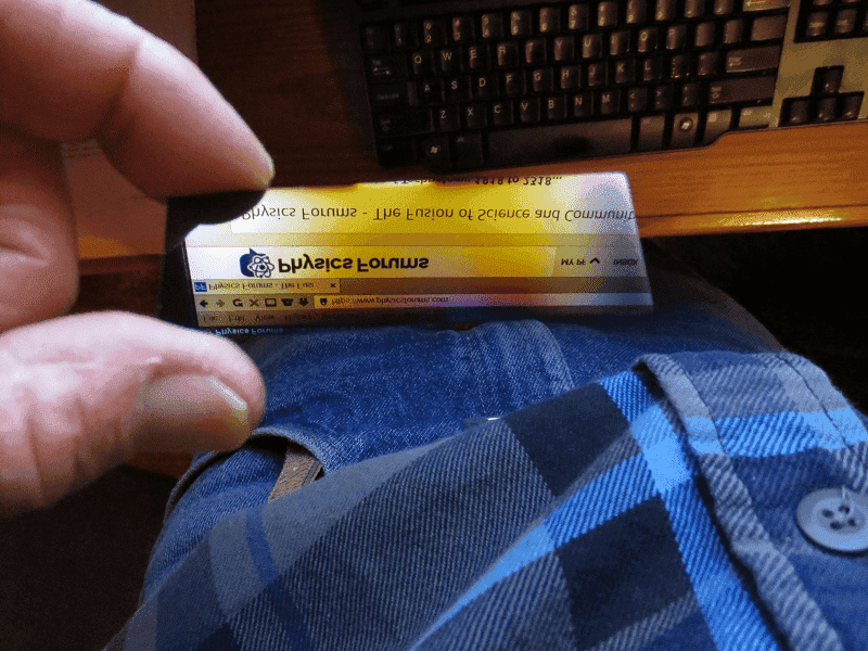

Since I mentioned this here in my beauty thread, I thought I might as well show a pic of my first thin film Copper deposition.

Is that a copper mirror reflecting Physics forums homepage from screen?
Impressive !
Would it deposit copper coating on a metal part ?
I believe so. I have to clean all the metal components in the bell jar after every run. I don't think that the film would be very strongly attached as it would be from sputtering.
BTW yes. that's the copper on glass slide reflecting the PF home page.

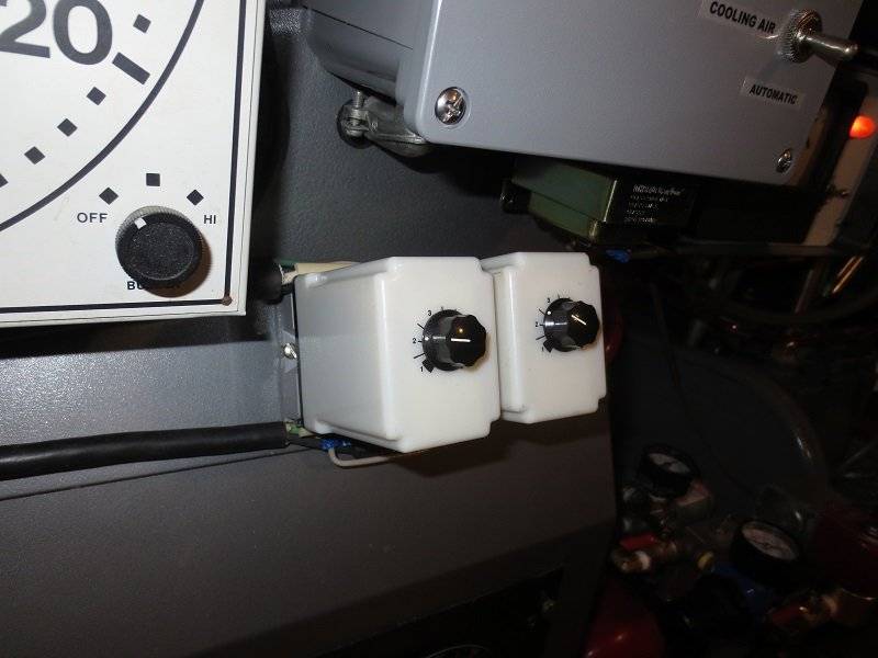

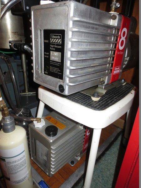

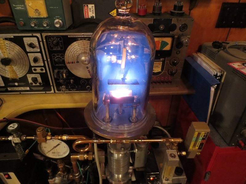

I thought I'd share a couple pics of the vacuum deposition (now sputter) system I've put together with mostly old "Beauty" components. I am just about ready to give it a try to see if it'll sputter copper onto glass. I've added a little heat exchanger to bring the temperature down on the electrode cooling air and made a HV tube power supply for the sputter potential (adjustable up to ~2kV). Also have Argon that I'll introduce after a good pump-down to help get a copper plasma.

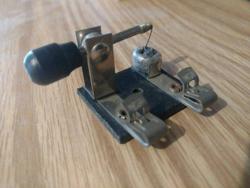

I have had this little detector for quite a few years now. I don't recall what I paid for it but a HAM that I used to work with sold it to me for what I recall being quite reasonable. He is deceased now so it means a bit more to me. Thought I would make it my avatar but it also fits in this thread just fine.
Thanks for sharing this beauty. Can you explain a little how it works?
I understand how it can give meaning to you. My HAM mentor (W0AFQ) would be in his 90s now and I'd love to let him know that his mentoring made a huge impact in my life.

Such variability, bordering on what seemed the mystical, plagued the early history of crystal detectors and caused many of the vacuum tube experts of a later generation to regard the art of crystal rectification as being close to disreputable.
The above is taken from a wiki article: https://en.wikipedia.org/wiki/Cat's-whisker_detector
Early semiconductors were not taken at all seriously since there was an association with the instability of the cat's whisker detector. I have never tried using one but as a kid I had a lot of fun tinkering with 'crystal' radio using a germanium diode. After a while I learned to plug the output of my crystal set into the mic input on a tape recorder and listen through the external speaker jack. My first experience with understanding amplification.
With cat's whisker detectors as I understand you would poke around with the thing until you got acceptable reception. Of course I can imagine trying a new stab at it because it was a shot in the dark and I would get greedy thinking there was a better spot on the crystal. I would assume moving the detector would also detune what it was hooked to. So if the detector gets bumped it probably also means a retune. Todays cell phone equipped kids have no idea what it took to get here. And for that matter I probably underestimate it plenty too.

One of the first companies I worked for used a lot of these 30 amp variacs. Except I think ours where manufactured by Superior Electric. When the company shut down I was able to get a few of them along with some power analyzers.
I love your sputter machine. Very nice job with all of these restorations.
I've made lots of tests leading to modifications on the thing. Not all that easy to get good results... Well not yet, but I just received some new caps in the mail for the HV supply from old jim. Thanks a bunch @jim hardy

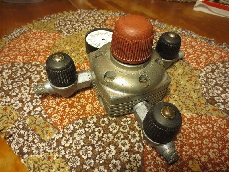

Vacuum leaks are a pain in the butt. So I picked up a couple vacuum gauge beauties that helped me find those leaks. With a good vacuum now, I just tried evaporated Aluminum on a glass slide. Here are the gauges and some Aluminum reflections.

berkeman said:
How big is that sheet in the bottom pic? It looks giant!
It's a 1" x 3" glass slide.
