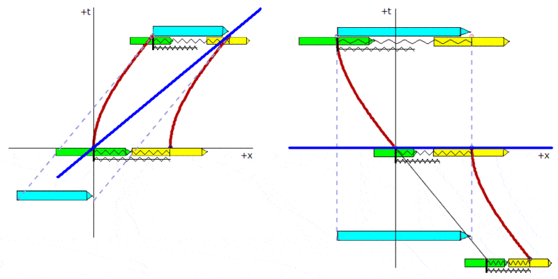

You could always refer to the diagram I posted in post#1 of this thread which has the paths and points in spacetime accurately drawn using geometrical software with coordinates tranformed using the the Lorentz transformations.
Oooh, nice. I actually didn't read #1 until now. :smile:
One thing that would be nice to see in the diagram on the left is this: Two dots, somewhere in the middle of each world line, marking two events where the two clocks show the same time. (They would be on the same horizontal line in the diagram). Also, simultaneity lines, showing what events co-moving observers consider simultaneous with those two events.

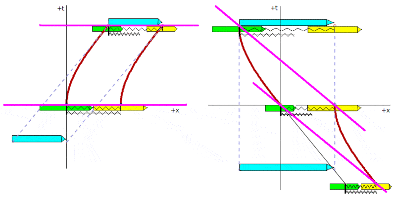

I have uploaded two more diagrams.
The first has solid magenta lines added that show the lines of simultaneity of an inertial observer that remains in the initial reference frame of the green and yellow Bell's rockets.
The second has solid blue lines added that shows the lines of simultaneity of the blue rocket that represents an inertial observer that stays in the final reference frame of the Bells rockets.
Not exactly what you asked for but the rest can easily be extrapolated.

Have a look at this link to a drawing of the classic Minkoski diagram of an accelerating rocket. http://www.mathpages.com/home/kmath422/Image5456.gif it has the worldlines converging and represents Born rigid acceleration ,where the accelerating observers measure their separation to be constant while the inertial observer measures the separation of the accelerating observers to be length contracting. This represents the classic equivalence of an artificaly accelerated rocket to gravitational acceleration. The equivalence princple is only valid over a short range so if you wanted to nit pick you could point out that this represents acceleration proportional to GM/R rather the normal Newtonian GM/R^2. You could also point out that this classic equivalence diagram shows the event horizon being at the origin rather than at 2GM/Rc^2 but we won't go there for now. However, the point is that the acceleration is inversely proportional to the distance from the origin as is normal for gravitational type acceleration. This represents the G/H and J/K pairs.
The rockets in Bell's paradox experience constant and equal acceleration. Their wordlines in the Minkowski diagram would be parallel (translated) rather than converging as shown in the Born rigid case. The bell's rockets have acceleration that is independent of the displacement along the x axis. That is the E/F type acceleration described earlier.
