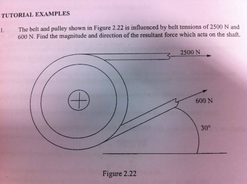

Hi guys,
I am working on a simple belt and pulley question, as pictured below.
To find the magnitude, I used the following equation:
(g(M-m))/(M+m)
So,
9.81(2500-600)/(2500+600) = 6.01 - Answer = 6kN
Is this correct, or am I doing it totally wrong? I have searched for the same question but didn't find any like this with a single pulley, all other examples seem to show 2 pulleys.
Any help would be greatly appreciated.
(g(M-m))/(M+m)
I don't understand that expression. Where did you get it? (Are m and M masses?)
In any case, why not just find the net force on the pulley due to the belt tension? Add up those tension forces vectorially.
Yes, they are masses. That's a formula I found via Google.
How would you attempt the whole question?
Masses of what? How is that relevant?
Do as I suggested in my last post.
