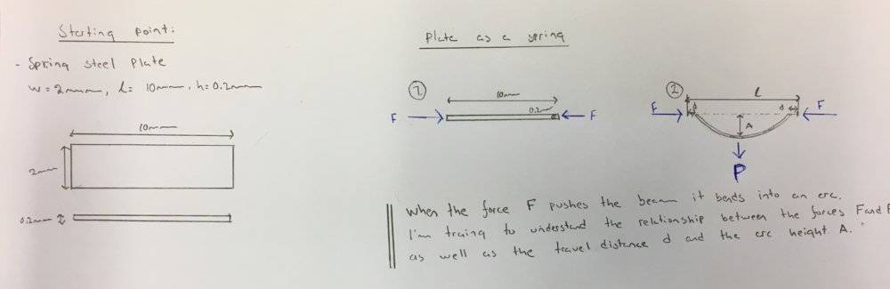

Hi,
If I have a straight beam and I start to push its ends towards each other with force F, the beam will obviously bend into an arc. What is the height/amplitude at the center of the arc when the beam length is l and the beam ends have been displaced by d. How much force (P) the center part can withstand before the beam starts to become straight again.

Sounds like the classical problem of the elastica. Are you up to speed on elliptic integrals?
Are you trying to permanently bend the beam, or do you want to use it as a spring? Either way, we need some dimensions and/or forces. And a diagram is always helpful.

Here is a diagram of the problem. The steel plate could be made from some spring steel grade, eg. SAE 1080. The idea is that the plate functions as a spring so we have a repetitive cycle from straight to arc and back again. Of course in real life the plate could be pre-bent just a bit, so that the plate would always bend into the correct direction. From mathematical perspective it is probably easier to analyze the movement from straight-to-arc.

You have an Euler column. Search the term to find the equation. Euler columns can work very well in applications where you want a rigid support that deflects at a particular load. Some things to watch for:
1) If the load is applied suddenly, the inertia of the column will (for a few milliseconds) act to stiffen the column.
2) You need to check that you do not overstress the column at peak deflection. Just run a test where you deflect it twice too far, and see if it comes back to straight.
3) A slight bevel on the ends will cause it to buckle in the desired direction. Do not prebend it.
The equation really does work. I once used some carbon fiber rods as a combination linear pushrod and Euler column overload device. They deflected at exactly the calculated load.
