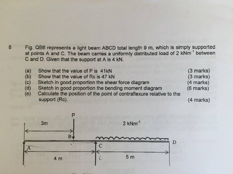

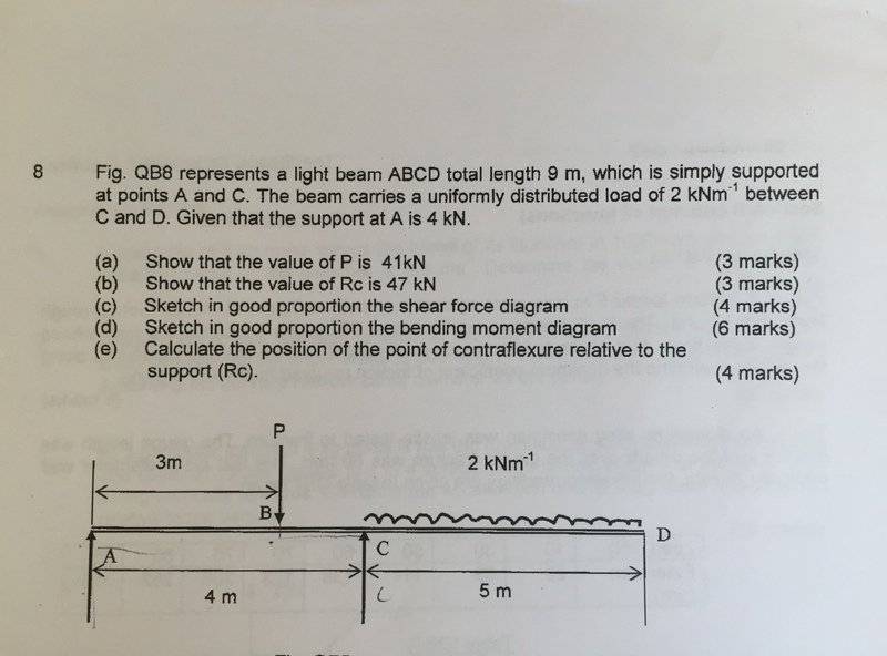

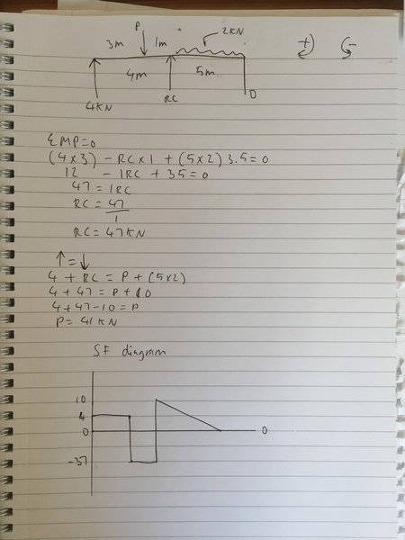

Hi
I am attempting a question on moments and beams.
I have attached the question and my solutions so far. But having trouble completing d) and e)
Can someone show how to work out bending moments and the point of contraflexure?
http://[ATTACH=full]199767[/ATTACH] [ATTACH=full]199768[/ATTACH]
[ATTACH=full]199769[/ATTACH]
any help is appreciated thanks

What have you done on part d so far. To you know how to determine the bending moment variation, given the shear force variation? How are the two related?
Chet
Having trouble doing bending moments and points of contraflexture. That's why I need help!
