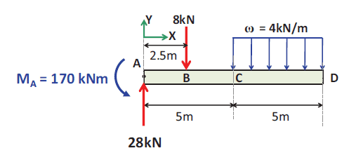

Hello
I am a bit confused how to calculate the shear force and bending moment graph for a beam under point loads, distributed loads and bending moments.
Is the discontinuous functions the best method to solve such problems?
Can anyone outline an approach?
I don't understand for example how to divide the loads in regions etc.
Thanks

Can you please provide a specific problem that we can focus on, so it will become clearer what your issues are?

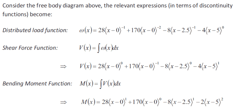

In this example, the equations are as below. How do I make the graphs out of these equations ie how do I find the right function for each zone?

You start out by determining the reaction force at A. What is that equal to, and what is its direction (upwards or downward)?
Next, you make a cut in the beam at location x between A and B. You then remove the portion of the beam to the right of x, and apply an equivalent shear force on the cross section at x so that the portion to the left of the cut is still in force equilibrium. What is the magnitude and direction of that shear force?

I want to know how to use the discontinuity functions in the second image to create the shear and bending moment graphs.
I know the first step to do that is to divide the beam into regions. I know the regions are:
0-2.5
2.5-5
5-10
But what's next?

The next step is to answer the handful of questions I asked. Do you think you can do that?
I am not stuck at that point, but further down, but anyway.
Something else: Can you tell me what are the boundary conditions for the bending moment function between B and C?
What is the moment in B and C? I know the moment with centre A, is 170Nm. I know the bending equation in B<x<C is in the form of ax+b but I don't know a and b.
I am having difficulty on how to find the moments in the section B-C. Any hint?
FYI so that you won't ask me again, these are the reactions forces and reaction moments (28kN and 170Nm):

You are being very uncooperative, so I'm going to give you the shear force variation:
##V=28\ kN## for ##(0<x<2.5)##
##V=20\ kN## for ##(2.5<x<5)##
##V=20-4(x-5)\ kN## for ##(5<x<10)##

Thanks but I asked for the moments in 2.5<x<5?
Well, now that you know V vs x, and you know the moment at A, you should be able to determine this. So, first, what would you get for the moment variation with x in the region (0<2.5<x)?

Following the method of graphs, we integrate the V(x) so for 0<x<2.5, it is:
M(x) = 28x+C
At x=0, we have M=170, so the above becomes:
M(x)=28x+170
But what about 2.5<x<5?
Again we integrate V(x), so it is:
M(x) = 20x+D
But what are the boundary conditions for M in 2.5<x<5? (that was my initial question)
Something else that I am a bit confused is the signs conventions, so can you correct the below appropriately please:

Actually, the way you have drawn the moment in post #7, the equation for the moment should read ##M(x)=170-28x##. At x = 2.5, the moment is M(2.5)=100
M(x) = 20x+D
The moment is continuous across 2.5 (since there is not a concentrated moment applied at 2.5). So, in this region, ##M(x)=100-20(x-2.5)=150-20x##

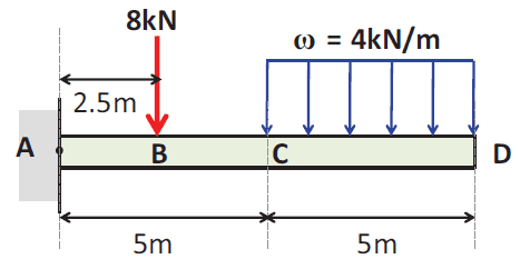

Also, something else please (this topic drives me mad as there is no COMPREHENSIVE approach).
In this graph, you have Sum(M at A) = 0 so 3*20 + Rc*8 = 0.
In this graph, you have again Sum(M at B) = 0 but Mb + 3*1 + 2*4 = 0.
Why in the first instance we don't say Ma, while in the second instance we do say Mb?

Are you asking why, in A, there is no moment at A?
Exactly.
physea said:
Exactly.
In A, the beam is mounted on a swivel which is incapable of applying a moment. In B, the beam is built into the wall (cantilevered), which can apply a moment to the beam.

1) So only in fixed/built-in supports we have a reaction moment?
2) I am not sure why in swivel you cannot get a moment, isn't it that the beam can still rotate around the swivel?
1. If anything constrains the beam to prevent it from freely rotating at a given location, it can exert a moment on the beam at that location.
2. A beam being able to rotate is not a criterion for a moment to exist (where did you get that idea?); a moment will exist if the beam is constrained from rotating.
