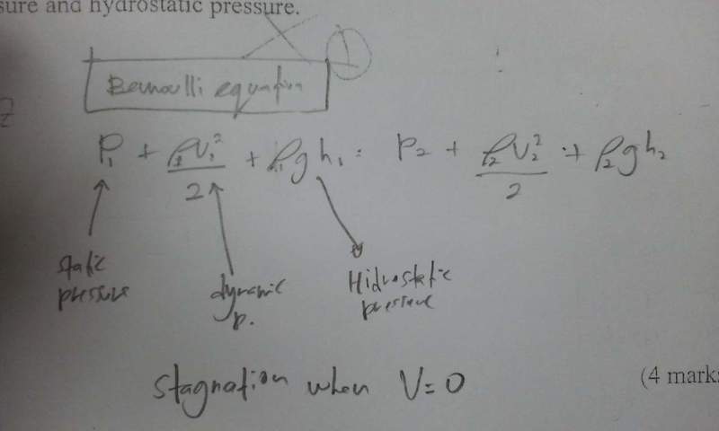

zainulariffin
dear PF..
what is the Bernoulli equation in terms of energy per unit volume
the equation include the
1) static pressure
2) hydrostatic pressure
3) dynamic pressure
4) stagnation pressure
Think about it, what's Bernoulli's equation?
p/ρ + 0.5v2 +gz
What's that form of the equation in terms of?
got it..thanks..
