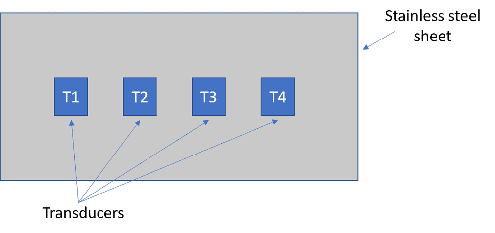

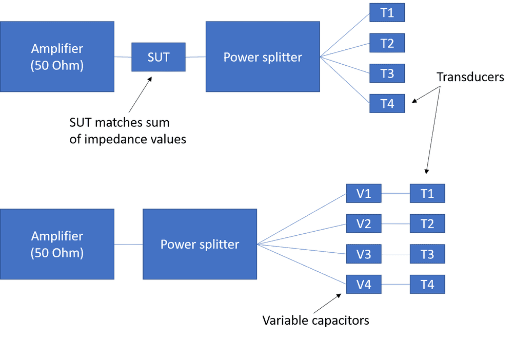

I am trying to figure out the best way to match impedance values between an amplifier (50 Ohm) which powers a number of transducers (initially 50 Ohm but could change). For one transducer I have previously used a step up transformer (SUT) device between the amplifier and transducer. Now I have multiple transducers.
The signal from the amplifier (40 kHz, 2000 W, 50 Ohm) will be split by a power splitter which feeds 4 transducers. Would it be best to place an SUT between the amplifier and power splitter to match all of the transducers at once, or have some sort of variable capacitor for each transducer (after the power splitter)?
I will also have to use some device to measure the impedance values, I like the idea of the smith chart...
But the instruments are quite costly. Are there any other instruments that would do something similar at 40 kHz?
Thanks for any advice.

Wow, interesting problem. Given the situation, I don't think it's practical to try to series-connect the transducers to improve the efficiency. It seems like you will need an impedance matching network/module for each transducer, driven by your power splitter (like in your 2nd diagram in your OP).
Do you know if any manufacturer makes power matching modules that can sense the mismatch and adjust the impedance transformation dynamically? It seems like that's the kind of building block you need in order to feed power to each of the transducers. If nobody already makes such a module, you may need to figure out the best way to design and build your own. What do other people in the industry do in this situation? Just try their best to come up with a compromise matching network for the anticipated power level?

Indeed. This is why I wanted to match each individual transducer first by a method yet to be determined, then also have some integrated impedance matching device incase the impedance changes with operation.
The matching device I used previously was an SUT:
https://www.tcpowerconversion.com/rf-impedance-transformers
Which worked well for matching a single transducer to the amplifier, but it only worked when the amp gave an RP value. This way the frequency of the amplifier could be altered slightly to reduce the impedance and then the SUT could be switched to its most effective impedance selection value.
Other people in industry,as I understand, use either a computerised smith chart, filter network and / or tune their circuits.
I don't have the funds to buy an SUT for each transducer. I just need a way to measure the reflected power (RP) from a single transducer, then I can develop a matching circuit for it, repeat for each transducer, then use the SUT to match the sum of the lower impedance values.
But no idea how I would measure the RP whilst in operation (which gives some idea of impedance mismatch).

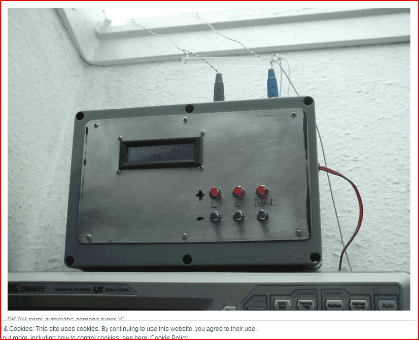

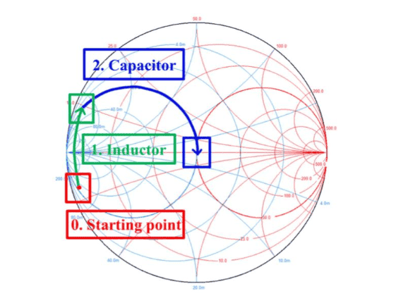

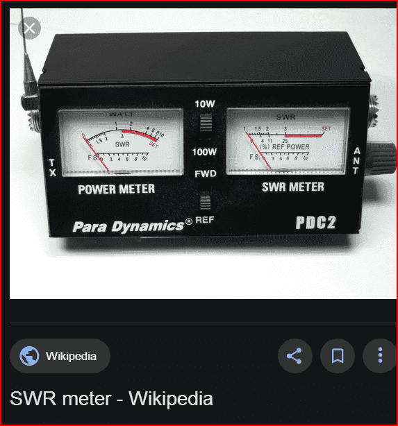

In HAM radio, we use in-line SWR meters to ensure that we are getting a good match between our amp and feedline and antenna:
Maybe something like that can work for you. You'd want to check the bandwidth of the SWR meter to be sure you were getting one (well, several) that covers down to your 40kHz Ultrasonic frequency band.
You might also do some reading about HAM radio antenna tuner devices, since that is their purpose to match the output impedance of the amplifier to the feedline and antenna (the antenna may be well off of its natural resonance, depending on its size and configuration). I don't know much about them, but they may help you think of ways you can set up your system...
https://radiotransmitter.wordpress....d-improving-the-semi-automatic-antenna-tuner/

Very interesting berkeman I will look further into this idea, thank you.

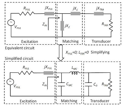

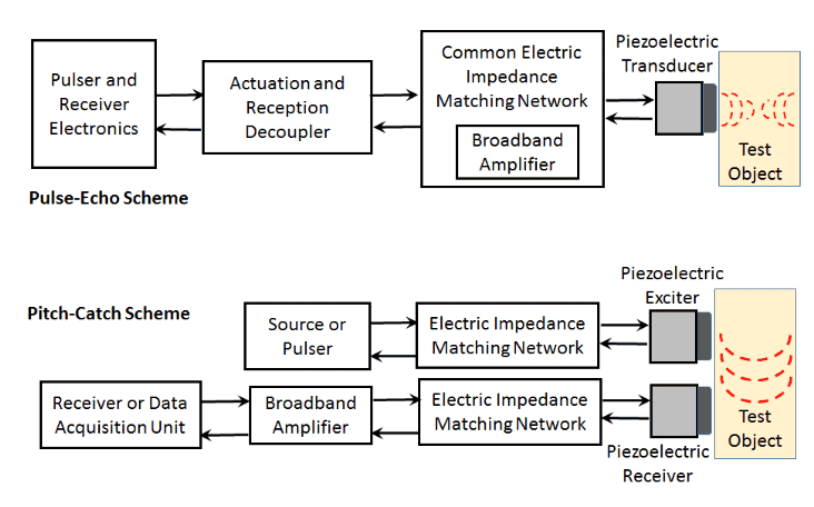

Btw for those who may find this in the future, I found a really good paper on impedance matching
I will be using their "Single Resonant Frequency Based Design" (see 3.1.) for matching except with a variable capacitor:

What type of power splitter do you use? It may be absorbing reflected power.

Just started working on that aspect today. In contact with this company...
http://uk.pasternack.com/power-dividers.html
The power splitters they provide are 50 Ohm, which is what I need, but I had not considered that they may adsorb the reflected power! I could potentially remove the power splitter and just tune each transducer direct to the amplifier, is that what you would suggest?

The 2 kW is split so it feeds multiple transducers, for example 50 W+ power dissipation per transducer. The high power allows us to add more transducers if we require. The four transducers must be at the same frequency because the frequency is given by the signal from the amp, which then split. In phase, I'm not sure exactly of the context of that question, but ideally the transducers would vibrate at the same time to get the metal sheet to resonate efficiently.
Thank you for the H-bridge suggestion, do you mean use a H-bridge as a splitter? We need a broad bandwidth, high power, RF power source.
Adjusting the frequency per transducer is a very good idea and something we are working on!
Do you think that having a variable capacitor circuit for each transducer would not work very well?

Apologies for any confusion. I agree my technical knowledge when it comes to electronics is limited, that's why I posted the question, to learn more. When I say 50+ W this could be greater than 50 W and will be dependent upon the power capability of the transducers. Also, as mentioned, we may wish to add more transducers to the plate. This is why I stated a value of 2 kW (the maximum power my amplifier has to offer).
The plate must resonate because I am studying the surface vibration behaviour. This will be done in air using an instrument such as a Micro epsilon optonCDT (https://www.micro-epsilon.co.uk/service/glossar/optoNCDT.html) for displacement of the plate in the micron range and an eddy current probe (http://www.monitran.com/products/eddy-current-probes-and-drivers) for mm range displacement. These are point measurements. I would like to go with 3D mapping, such as with a 3D Laser Scanning Vibrometer, but the equipment is very expensive.
Hope that helps.

The test sheet / plate will initially be 1m by 1m and around 1 inch thick, it will be square in shape.
OK, thanks. And what mode will you be studying?
