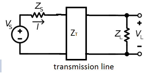

Assume we have a general rf system where source with impedance ##Z_S##
transfers a signal to a load with impedance ##Z_L## through a transmission
line with impedance ##Z_T##. We want to match this system
in order to maximize it's effiency:
In
https://en.wikipedia.org/wiki/Impedance_matching
there are two options how to do it if we deal with power transfer
from source to load through a transmission line:
There is one way to to maximize the power transfer; the
condition that should be fulfilled is ##Z_S = Z^*_L## and on the
other hand there is a way to minimize the reflexion of the signal waves.
To do this the relations between the source and transmission line
should satisfy ##Z_S=Z_T## and and between
load and transmission line ##Z_L=Z_T##.
Obviously, it is not possible (if the system contains reactant components)
to fulfill both conditions, ie to maximize the power transfer AND
to minimize the signal wave reflexion.
My question is what to do in such situation? How to decide what to do
here in order to run the system with best effiency? How to decide
what is more important: to maximize the power transfer or
to minimize the signal wave reflexion? Is there a kind of guide
how to decide in such or similar cases?

I think that this is not possible, because, let's try it:
1. We match the source to load via maximization
of the power transfer. So we get
##Z_S = Z^*_L##.
2. We match the source to the transmission line to
minimize the signal waves reflexion. So
##Z_S = Z_T##
3. We match the load to the transmission line again to
##Z_L = Z_T##
If we try to obtain 1, 2, 3 simultaneously, we would obtain
##Z_S = Z^*_S## and ##Z_L = Z^*_L##
And in general as I said before that's pure mathematically wrong, if
our source and load have reactant components. That's
exactly my problem. How to resolve it or where is the
error in my reasonings above?

You assume that step 1. matching of the source to load via maximization of the power transfer is needed. But that energy transfer efficiency comes by virtue of the fact that the device at each end of the line is matched to the line.
Maybe since you mention the presence of a reactive component, you are assuming that only the real R is to be matched, and that any reactive X will not be neutralised. But matching for energy transfer involves both R + X j , at both of the independent ends of the transmission line.

Rule number one. Do not accept standing waves on the transmission line, they are evil.
Match the source into the transmission line, with a perfectly matched termination or loss network at the far end, so there is no reflection possible. Then replace the perfect termination with the load, and match the load to the line.
So long as you use the line as part of the matching network, you must have standing waves. Standing waves indicate that energy is passing through the same line losses several times, which is not an intelligent way to match a high power line.
Low SWR may mean you have a perfect match. It may also mean you have a lossy line that can hide a mismatch. Where does the lost line energy go? It heats the line, melts the dielectric, then hopefully triggers a reflected energy automatic shutdown, before the fire starts.

Ok, so in case of the toy network from my opener post we should
match it as follows with only two steps:
1. M1: Match Source with Transmission Line via minimization
of reflected waves, so ##Z_S= Z_T##
2. M2: Match Transmission Line with Load via minimization
of reflected waves, so ##Z_T= Z_L##
And that's all? So my error in post #7 was has been
step 1. Should it considered as general strategy for
matching multistaged networkes by matching only
the immediate neighbours? And if the neighbour it the
transmission line, then the match is always realized
by minimization of signal reflexion?

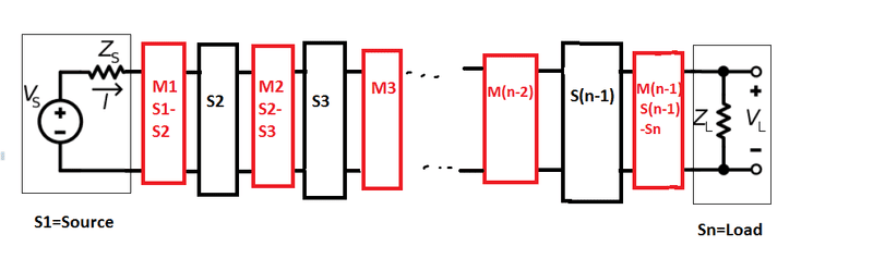

If I have rephrased your idea correctly, can this idea be
generalized as follows:

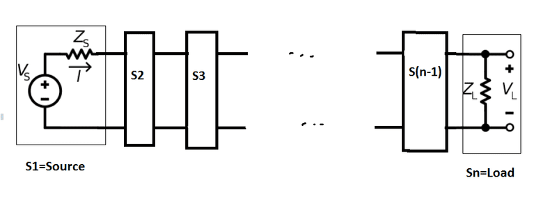

Say we have a multistaged network between ##n## connected
subkomponents ##S= S1, S2,..., Sn=L##:
and we want to match it. Can the general starategy be summarized as
follows:
1. The matches should be performed successively ONLY
between immediaty(!) neighboured components, right? ie there should be
always performed only ##n-1## matchings: between
##S1## and ##S2##, then between
##S2## and ##S3##, and ... and between
##S(n-1)## and ##Sn##. And no other matches especially between non neighbours are required?
In other words, eg it should be not tried to match
between not neghbours like eg ##S2## and ##S5##?
So we obtain:
2. Next, how to match ##Si## to ##S(i+1)##? In general as I
stated above there are two options:
maximizing power transfer (with ##Z_{Si} = Z^*_{S(i+1)}##)
or minimizing reflected signal waves
(with ##Z_{Si} = Z_{S(i+1)}##)
Having considered your explanations on the toy network from above, can it be stated/generalized as follows:
If ##Si## or ##S(i+1)## is
a transmission line, then we should
minimize reflected signal waves, so ##Mi## realizes
##Z_{Si} = Z_{S(i+1)}##. Otherwise, if neither
##Si## nor ##S(i+1)## is tranmision line, we
maximize with ##Mi## power transfer with ##Z_{Si} = Z^*_{S(i+1)}##.
Is it correct, or is the story here more complicated?

That is correct, you now understand.
But by repeating the problem many times, you are making it seem more difficult than it really is.
You must consider what you class as a transmission line, is it long and lossy, or short and efficient? In all cases you might use a Smith chart to design and cut a line to perform the match, but that can be very costly for high power, or for long, or lossy lines.
It is easy to get carried away with using a Z0 = √(Z1*Z2) transmission lines to match modules. When you are holding a hammer, everything looks like a nail.
Be very cautious before encouraging standing waves.
It is often the case that redesigning one module, to match its two adjacent modules, can eliminate two transmission lines and four matching networks.

Ok, so here seems the point to be should I regard a transmission line as a partial components of the whole network (ie as a ##Si## in the notation from comment #12 or not. And this depends on how so it is, with which characteristic frequencies I work and and and.
Ok, bit if we assume that I'm able to decide is the transmission line relevant for the network or not, then there are only two options how to proceed:
1. I recognize the transmission line as important for the matching procedure. Then, regarding it as network component ##Si##, I should do two things, match it to ##S(i-1)## and ##S(i+1)## via minimization of reflection waves, ie match such that ##Z_{S(i-1)}= Z_{Si}## and ##Z_{Si}= Z_{S(i+1)}## and proceed to next stage ##S(i+1)##
2. Recognize the transmission line as not relevant, eg id it is to short with respect the wave lengths I'm working with. Then ignore it just and proceed with the match between ##S(i-1)## and ##S(i+1)##. If ##S(i-1)## and ##S(i+1)## are not transmission lines, do matching via maximization power transfer, ie ##Z_{S(i-1)}= Z^*_{S(i+1)}##, if ##S(i+1)## is transmission line, decide again if it is relevant for the matching or nor and play the same game as before with it...
Is this "pseudo-algorithm" correct on dealing with transmission lines in multistaged network?
It will still be sub-optimal in many cases.
Do you need to delay or relocate a signal? If yes, consider using a transmission line.
Do you need to match two stages? If yes consider a short transmission line as one of the many possible solutions.
When the system could be simplified by modification of a stage interface, avoid the complexity and cost of a kludge. https://en.wikipedia.org/wiki/Kludge
The quarter-wave transformers used in optics are implemented by coating the transmission surfaces. Quarter-wave transformers for RF can be bulky, and are often better replaced with a compact Pi or T, or for broad-band, with a transformer or a tapered LC ladder network.
A quarter wave transmission line on a PCB can be designed to have a tapered characteristic impedance by controlling the width. That is often better than having several quarter wave stages with geometrically related impedance steps.
I think this is pretty close to correct. If the line segments are long enough to manifest TL effects (and thus generate reflections), it is best to use matching networks to minimize reflections and wasted energy. If the joining sections are short, the matching networks are probably not needed. Note though that even RF connectors are designed for a particular impedance generally, even though they are electrically short at RF frequencies.
