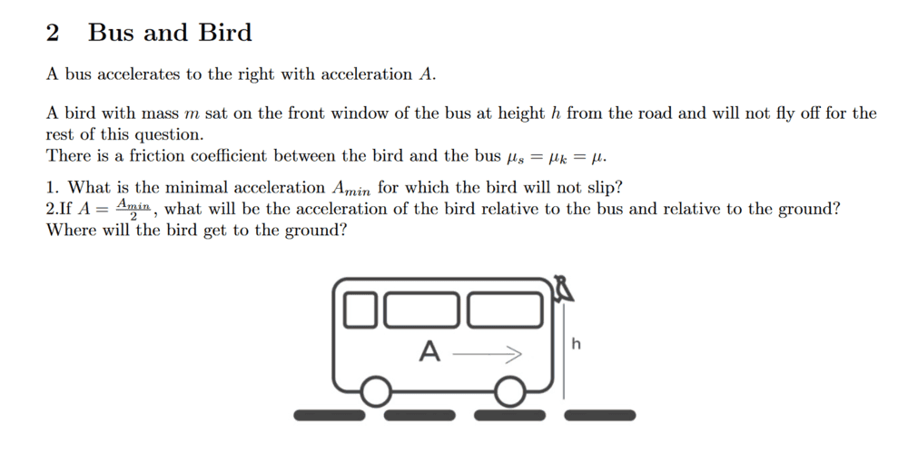

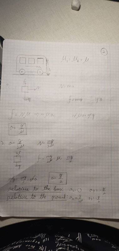

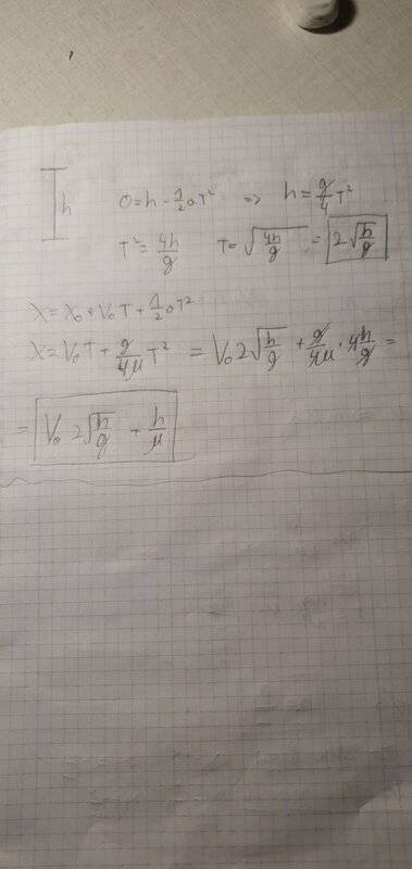

i attached the problem and my solution, is my solution right? thank you

In your second part ##V_0 = 0## other than that everything looks good to me.
