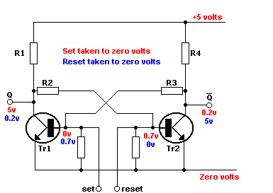

I want to know the BJT implementation of RS flip flop...Thanks for ur reply

Thanx for your reply...it was really helpful for me...Can u suggest me some good books on digital electronics, I am at beginner level..
You could read this description of R-S flip flops:
http://www.hobbyprojects.com/flip_flop/a_transistor_RS_flip_Flop.html
It describes this circuit:
Transistor R-S flip-flop schematic with two NPN transistors Tr1 and Tr2 cross-coupled through resistors R2 and R3, pull-up resistors R1 and R4 to +5 volts, outputs Q and Q-bar, and set and reset inputs; voltage labels at each node.
