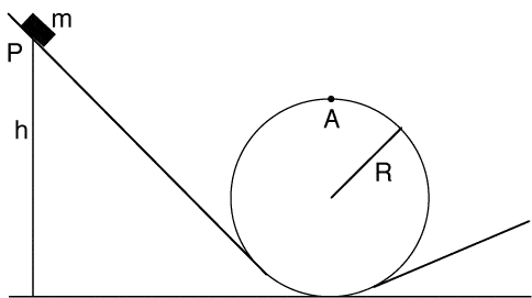

A small block of mass m = 1.3 kg slides, without friction, along the loop-the-loop track shown. the block starts from the point P at rest a distance h = 52.0 m above the bottom of the loop of radius R = 18.0 m.
A)What is the kinetic energy of the mass at the point A on the loop?
B)What is the magnitude of the acceleration of the mass at the point A of the loop?
C)What is the minimum height h for which the block will reach point A on the loop without leaving the track?

I am unsure how to go about this problem. Can someone help me out and walk me through it Please! I guess we can just start with part A and work our way from there.
In order to get help on this forum, you have to show some work. What are your thoughts on this problem? You knew enough to notice that the energy relations will be important here. This is correct.
HINT:
Is anything conserved?
Well what I tried to do was set 1/2mv^2=2mgh, and solve for a velocity. Then I tried to plug that into KE=1/2mv^2, but I don't think that is right. Is the total mechanical energy conserved?
Yes, the total mechanical energy is conserved. What does this tell us about the values of the total mechanical energy at P and at A then?
They are both constant? right?
Yeah, the mechanical energy is constant and doesn't change. So, what is the mechanical energy at each point?
is that where you use KE_1+PE_grav?
Yeah, that quantity is the mechanical energy at a point. Can you find that quantity at P and A? If you can, you should be able to see how this leads you to your answer for part a).
How do I figure out a velocity to use in the equation?
You shouldn't need it. The quantity 1/2mv^2 at A is the kinetic energy at A. You want to know what this whole quantity is. So, just solve for that quantity. Now what about the 1/2mv^2 and P? Do you know v at P?

For the speed at P, the problem statement tells you that the block starts at rest. What does this tell you about its initial speed and thus the kinetic energy at P?

Now, the acceleration at A may be equal to g, but it may be greater depending on how fast you are moving around the loop. Now, what do you know about circular motion? The acceleration would be a centripetal acceleration, correct? What relationships can you use to find a centripetal acceleration?

For part C I don't even know where to start. mv^2/r must be greater than or equal to mg, right?
For part, C, the minimum speed at which the ball can make it over the loop is when the centripital acceleration is equal to g. Now, using this fact, can you work backwards, using the methods from parts a) and b) to find the height at which it should be released?

Well, once you know that the centripetal acceleration at A is g, can you find the speed at A? Once you find the speed at A, kinetic energy is no problem, right? Then does conservation of mechanical energy tell you anything?
So when I take the velocity from the centripetal acceleration, and plug it into KE=1/2mv^2, I get 114.63 J. Is this right so far?
Yes. Now what can you do from here?

I understand that it is a constant, so does that mean KE+PE equals the answer from part A?
We are changing the centripetal acceleration, so the mechanical energy isn't the same as it is in part A, but it is constant from one point to another. What does this tell you about the mechanical energy at point P in this part?
I haven't done this before so I am really confused right now. I am not sure what it tells about the mechanical energy at point P.
It is constant from one point to another, so the total mechanical energy at point A has to be equal to the total mechanical energy at point P.
So then can the lowest the height at Point P only be equal to the height of Point A which is 2r?
