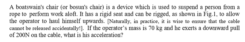

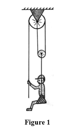

The question has been screenshotted, along with the given diagram. Basic stuff I know, but I can't seem to get my head around pulley systems. T
F(net) = m ⋅ a(system)
I understand the rope to be considered inextensible. Also, I understand that the tension must equal the weight of the man & chair, but beyond that I don't know how to break it down.
I labelled a reference frame with x being positive down.

I done that, labelling F(down) as 200N + mg, => F(down total) = 887N.
Regarding the tension, I labelled T moving up from the man to the smaller pulley. Would that then split into 1/2T either way up the pulley, or would it remain T?
I also labelled T pointing up on the rope which the man pulls down on.

How many ropes attach to the man&chair? If each has a tension T, what's the net force upwards?
One rope attached directly to the man and chair, therefore T up? Also, would 200N be T, due to Newtons 3rd Law?
Therefore, Net Force Up = 200N?
In fact, there are 3 ropes above the man and pulley, therefore F(up) = 3T.
T = 200N as the man exerts this force down the rope and so the rope exerts this force up on him.
That means that F(net of the system) = mg - 3T, => 686.7 - (3*200) = 86.7N downwards.
F = ma, a= 86.7/70, => a = 1.24 m/s^2?
No, there are two ropes connected to the man and chair: One he holds directly, one connected to the chair.
The one he holds has a tension T = 200 N. What's the tension in the other rope? (consider a FBD of the small pulley).
F = ma, a= 86.7/70, => a = 1.24 m/2^2?
Yes! That's much better!
So generally no matter what, each rope has a tension T throughout the system, even if the rope reaches a pulley and looks to go into 2 separate ropes?
Thanks for the help!
If the pulleys are massless and frictionless, then continuous ropes have the same tension. When separate ropes meet at a pulley, their tensions sum (vector sum).
