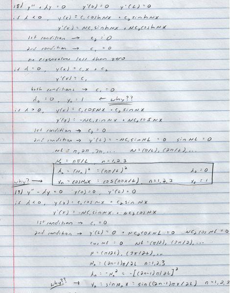

I need a bit of help with these boundary value problems. I'm trying to find their eigenvalues and eigenfunctions and although I pretty much know how to do it, I want to exactly WHY I'm doing each step. I attached part of my work, and on it I have a little question next to the steps I need explained. The biggest question I have is how do you know what form to choose for the eigenfunctions. Thanks a lot for taking the time to help me out.
  • Handwritten derivation of eigenvalues and eigenfunctions for boundary value problems y'' + λy = 0 with y(0)=0 and y'(L)=0, covering cases λ<0, λ=0 and λ>0, with boxed results λn=(nπ/L)^2 and yn=cos(nπx/L).

In the first problem, you have
[tex]y"+ \lambda y= 0[/tex]
with boundary conditions y'(0)= 0, y(0)= 0.
You first try [itex]\lambda< 0[/itex] and determine that there are no non-trivial functions satisfying that so no negative [itex]\lambda[/itex] is an eigenvalue.
You then try [itex]\lambda= 0[/itex] so your equation is y"= 0 which has general solution y(x)= C1x+ C2. y'= C1 so the boundary conditions give C1= 0. But C2 can be anything so there exist non-trivial solutions of the form y= C. That is,
0 is in fact an eigenvalue. Since the set of all such solutions is an "subspace" of the space of all functions, you can find a basis for it. The simplest is y= 1 so that y= C= C(1). Actually, any number (except 0) would have worked.
If [itex]\lamba> 0[/itex], then you get general solution
[tex]y= C_1 cos(\sqrt{\lambda}x)+ C_2 sin(\sqrt{\lamba x})[/itex]<br /> [tex]y'= -C_1/sqrtr{\lambda}sin(\sqrt{\lambda}x)+ C_2\sqrt{\lamba}cos{\lamba x})[/tex]<br /> The boundary conditions give<br /> [tex]y'(0)= C_2= 0[/tex]<br /> and then <br /> [tex]y'(L)= -C_1\sqrt{\lamba}sin(\sqrt{\lambda}L)= 0[/tex]<br /> which says that [itex]\sqrt{\lamba}L) must be a multiple of [itex]\pi[/itex] and so we must have <br /> [tex]\sqrt{\lamba}= \frac{n\pi}{L}[/tex]<br /> so the eigenvalues are of the form <br /> [tex]\frac{n^2\pi^2}{L^2}= \(\frac{n\pi}{L}\)^2[/tex]<br /> for n an integer (that, by the way, includes 0 which you had already found). That means that the "eigenvectors" or solutions are <br /> [tex]C_1 cos(\frac{n\pix}{L})[/tex]<br /> Again, any multiple of a single solution is also a solution so we might as well take C<sub>1</sub>= 1.<br /> The way you've written it, you have [itex]\lamba_0= 0, y_0(x)= 1[/itex] separate but you could as easily take <br /> [tex]\lamba_n= \(\frac{n\pi}{L}\)^2 y_n(x)= cos(\frac{n\pix}{L})[/tex][/itex][tex] with n= 0, 1, 2,... (since cosine is an even function, we don't get anything new taking negative values for n). <br /> <br /> I think your basic question in both problems is why, after having gotten a non-trivial solution, involving an undetermined constant C<sub>1</sub>, do they then drop the constant. The answer is that the set of all vectors satisfying the equation [itex]Ay= \lamba y[/itex] is a subspace of the set of all vectors and so there exists a basis for it. In particular, in these problems the "eigenspaces" are 1 dimensiona. Since we want a solution y<sub>n</sub> such that any solution can be written y= Cy<sub>n</sub> for some number C, and we already have y= C<sub>1</sub>f(x) we might as well take C<sub>1</sub>= 1 and use that. In fact, we could have as easily let C<sub>1</sub> be any non-zero number.[/tex][/tex]
That explained it perfectly! Thanks sooo much for taking the time help me out with that...and sorry about the .jpg

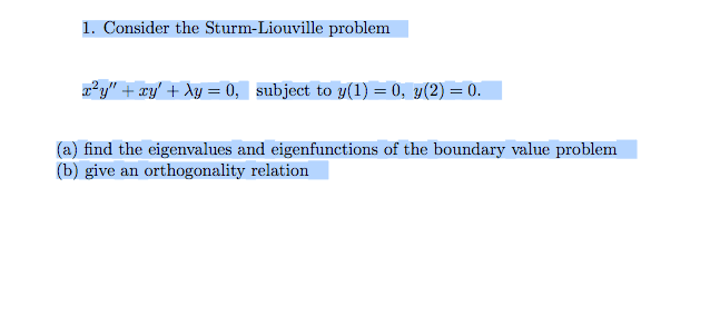

I also face a big difficulty in this question! Could anyone help me though, please?
  • Typeset problem statement: 1. Consider the Sturm-Liouville problem x^2 y'' + xy' + λy = 0, subject to y(1) = 0, y(2) = 0. Parts (a) find the eigenvalues and eigenfunctions of the boundary value problem; (b) give an orthogonality relation.

=) Sorry for breaking rules ! I just read HallsofIvy's solution again wisely ! and I found a way though =) thank you all
