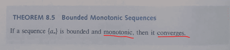

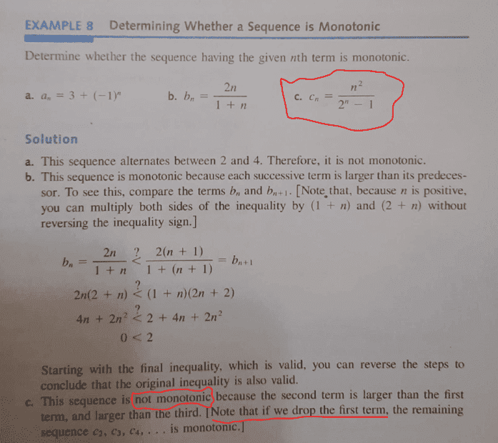

I would like some clarity on the highlighted part. My question is, consider the the attached example ##(c)##, This sequence converges ( by using L'Hopital's rule)...now my question is, the sequence is indicated on text as not being monotonic...very clear. Does it imply that if a sequence is not monotonic, then it would not converge? In any case, what is the importance or rather the relevance of determining whether a sequence is monotonic (finding upper bounds and lower bounds) or not? Why not just take limit for the sequence and have the job done?
Textbook page, Example 8: Determining Whether a Sequence is Monotonic, with part c circled in red, showing c_n = n^2/(2^n - 1) and a highlighted note that the sequence is not monotonic.
Textbook excerpt: Theorem 8.5, Bounded Monotonic Sequences. If a sequence {a_n} is bounded and monotonic, then it converges. The words 'monotonic' and 'converges' are underlined in red.
No. A sequence does not have to be monotonic in order to converge.
