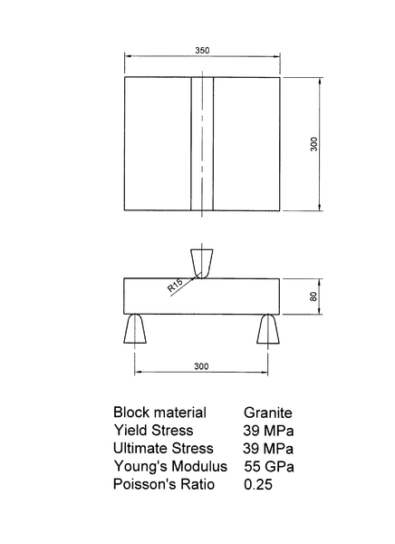

We can use that model if you are happy with it .
  • #32
  • #33
Nidum said:
If I did the math correctly, for the force at failure at the fulcrum R, I get: $$R=\frac{2}{3}\frac{wh^2}{L}\frac{\sigma_{ult}}{\sqrt{1-\nu+\nu^2}}$$
where h=0.08m, L=0.35m, and W=0.3m. This gives a value for R of 158 kN.
  • #34
Interesting . I'll do the FEA with that load later today .
  • #35
In this analysis, I assumed pure bending. This was probably not too good an approximation because of the stubbiness of the plate. Probably shear bending was a factor too. For a failure criterion, I used von Mises.

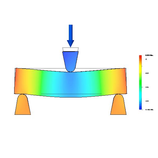

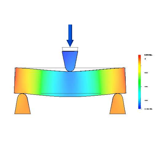

Load : 158 kN uniformly distributed on top of central wedge .
Top surface :
Max fibre stress : 33.9 MPa compressive .
Deflection : 0.1 MM
Bottom surface :
Max fibre stress : 21.2 MPa tensile .
Deflection : 0.097 MM
Values sampled at centre of block as seen in plan view .
Picture shows deflected shape .
Stress concentration effects supressed .
There already seems to be reasonable agreement between the analytic and the FEA results .
I want to try another run now with the applied and reaction loads acting on the plate as distributed loads acting on small definite areas instead of on the almost line contact areas of the wedges .
Something like 25% of plate thickness times the plate width for each contact .

Are you sure about the colors in the figure? Shouldn't the bottom be red (high tensile stress) and the top be blue (high compressive stress), rather than the colors being oriented vertically.?
  • #42
That view shows the deflected shape and the colours represent local vertical deflection values .
I'll post the stress distribution views asap .
