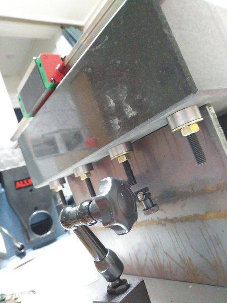

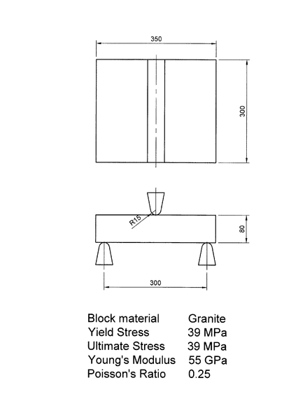

hello it's been two weeks to figure out how much force would it take to break a granite surface plate size of
1) 30x30x8 (cm)
2) 40x60x8 (cm)

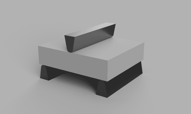

literally breaking it in half with a fulcrum underneath and two forces acting on the top
i've posted a number of forums (practical machinist, engineering forum, hobby machinist forum, etc, etc)
all the replies either "refer to your mechanical engineering textbook", "consult a mechanical engineer", use H-beam strength calculation formula, etc.
never a direct answer but beat around the bush type.
i've done my calculation based on the cross section of the granite:
UTS of granite 25~39MPA therefore 25~39 X 240/320 = 6000~9360 / 8000~12480 MPA
which translates to 61182.97~95445.44 / 81577.3~127260.58 kg
seems pretty good not sure if it's correct
----------------Q 2---------------------
also i assumed that as the distance of two forces acting upon the granite increases, proportionally the required force to break the granite decreases
so in order to counter that, using two metallic plates bolted on the surface plate directly beneath the two forces that would direct the force closer to the fulcrum, would it act as a transmitter that brings the two distant forces closer to the fulcrum?
please, i don't want beat around the bush type of answer
thank you :D

It's not. You've calculated the force required to break a granite block by pulling opposite sides in opposite directions the way you'd break a piece of string. Whoever told you to use the beam strength formula gave you good advice; your problem is equivalent to a beam supported at both ends and subject to a point load at mid-span.
If by "I don't want beat around the bush type answer" you mean "I want someone else to do the work for me" there's a beam strength calculator at engineeringtoolbox.com that will give you your answer.
Only if the metal plates were very strong and very stiff compared with the granite itself. That seems infeasible for any reasonable thickness of plate.

i think i didn't include this, but there will be metal plates bolted top and bottom sides of the granite plate.
wouldn't the granite have to bend the metal plate first to break?
also, in this case wouldn't the plate bring the forces at the edge close to the fulcrum?
once the metal plate has been bent enough to surpass the breakage point of granite, the granite will break

It is beam theory but with some more details needing to be taken into account than is usual in dealing with the more common long slender steel beams .
Simple beam theory becomes unreliable when beams are short and very thick .
Also granite material does not behave quite like steel so special care is needed to identify the actual mechanism of failure involved .

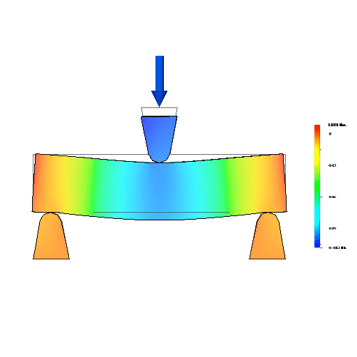

And that is how beam theory works. Compression on one side, tension on the other side, both increasing with the deflection.

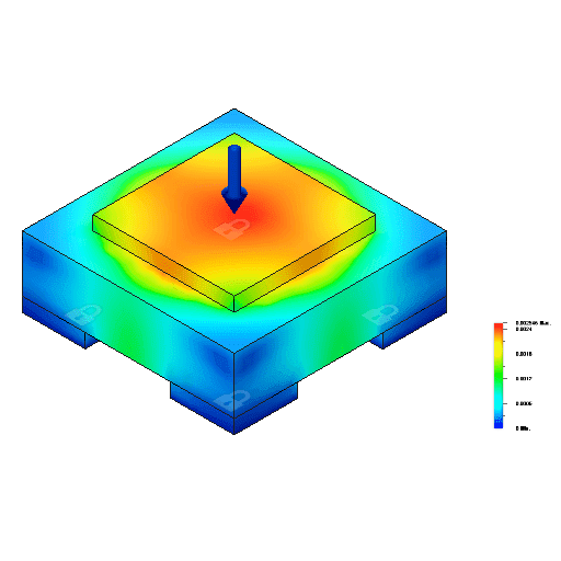

Actually, because the lateral dimension is large compared to the length, the granite should be treated as a plate. The basic analysis for a plate is similar to that of a beam, except for the significant lateral constraint.
This problem should first be solved without any metal reinforcement, and then the effects of the metal reinforcement should be included, treating the combined plate as a laminated composite.
Ahhh, of course. In a beam, the face under compression will tend to "fatten" out to the side while the face under tension will tend to "suck" in. But in a plate, the surrounding material prevents this. Thank you, Chet, for that insight.

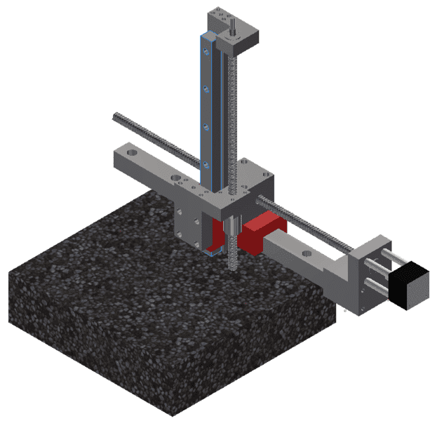

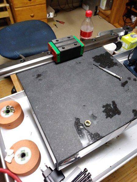

this granite will become the base of a machine which requires precision and rigidity
it will not be used as a beam, it's totally different
we're not talking just about pressure applied to extreme ends, there's definitely going to be pressures applied all over the place with all sorts of directions
not to mention the structure of machine parts (linear rail, headstock, mill column, tool post, etc, etc) afftecting this.

You're not saying that the plate is short and stubby, are you? Are you really saying that the length of the plate is only 8 cm, compared to the lateral dimensions of 40 and 60 cm?
This is easy.
1. By pressing down on each side of the granite, one exerts force on the fulcrum, which then forces the upper surface into tension and the bottom into compression.
2. Once tension in the upper SURFACE of the granite, exceeds it's tensile strength, it breaks by fracture through the mass. Like glass with a score line in the upper surface.
3. Remember it's not the tensile strength of the MASS, or the entire cross sectional area, as in pure tension through out the whole mass, only at the upper surface.
4. Use triangulation and vectors or two upside down right angles triangles, back to back - wide bases at the top, pointy bits on the fulcrum.

Granite_surface_plate_breaking_load_2017-Jun-25_08-58-29AM-000_CustomizedView3750219237.png
I've inverted the arrangement of supports and load that you described initially . Seems more logical for a load coming from machine weight to act downwards and centrally .
Is this now a reasonable interpretation of the geometry of your problem ?
Estimating the actual breaking load is going to be problematic . A better approach would be to determine a load at which we can be reasonably certain that the block will not break .
Quick FEA showed that with 40 kN on the central bar the bar itself failed first due to local crushing . Granite block still had large reserves of strength remaining .
With this load vertical deflection of top surface central point of block is 0. 02 mm relative to the outer ends .
If the actual machine is centrally mounted on the block with a large footprint area and similarly if the block is mounted on the support structure with well spaced pads with a large total footprint area I actually think the block is going to be so resistant to breakage and deflection that you need not consider this aspect of your design study any further .
Fitting steel plates is both not necessary and undesirable . The granite block is adequately stable , strong and accurate as supplied . Steel plates will just add complexity for no advantage .
40 kN applied load .
Worst displacement 0,003 mm at central point .
Least safety factor 8.
The usual (tacit) assumption is that the footprint areas are relatively large (say, on the order of a few plate thicknesses), so that the loading is not really close to the knife-edge type loading implied by Fizzy Hicks in post #18, and local crushing will not be a problem. Under these circumstances, ordinary plate bending analysis applies; I'm curious to know what does your FEM analysis predicts for such circumstances and, by comparison, what ordinary plate theory would predict for the failure load. If you're willing to do the FEM, I'd be willing to do the standard bending analysis for comparison.

if i am not going to use underside 1inch thick steel plate reinforcement as a washer, i am going to use washers 1cm thick made of 12L14 material with 5~8mm thick rim
to disperse force away from the drilled hole area to prevent cracks
currently i have drilled 4x 8cm holes 10mm diameter and mounted a hiwin hgh30ca series linear guide
the top of the rail has 2 micron flatness and so far it feels pretty solid
this machine is going to be a precision surface grinder

good cad design, if you created that just for this discussion i give a plus to you. good job!
some things to note though, your design is inverted from what I've been talking abought throughout this thread (it really doesn't matter though)
also, i don't consider 40x60x8 a small size for a base. this machine's base alone is 80kgs, that's not a "small" machineand i don't know what are you talking about?
good work!
thank you for your dedication!
gradient dispersion of force from center to edge as expected
if linear rails and reinforcement plates are installed, this could be quite a different story
however the result you've shown gives me hope
4 ton pressure and 0.003mm displacement hm... this could definitely be improved by reinforcement
i need figure out maximum displacement of granite. will 0.003mm displacement create cracks?
it's only 3 microns but i guess it could happen
for those wondering what my current project looks like here's the picture
it's a small machine using 30x30x8(cm) granite surface plate
a small but powerful variable speed grinder with vertical type stone will mounted on the Z axis
diamond dresser to true up the stone
i am expecting quite accurate surface grinding
one thing to note though, as the height of the head increases, rigidity decreases
so 1~15cm tall parts preferred for my operation
the maximum is up to 28 cm thick
currently drilled four holes and mounted bottom rail
i know it's just single rail but i used 30 series rail rated for tons of pressure in all direction
dual rail should be better but obviously more space will be sacrificed and more complexity
what do you guys think of this?

here's actual pictures of it
currently under construction
have many projects running at the same time so progress is a bit slow
but slowly will be finished eventually
i designed in such way so rigidity loss is miminum with minimal deflection
low part grinding should be a breeze
very tall parts probably have to take very small depth of cut
the washers i made are 9mm thick, 25mm diameter, 12L14 material, with a small contact side relief around center with 5~8mm rim(contact point)
the bolts are M8 X 150 (4 of them) 6cms apart
measured the top side of the rail with a test indicator
2 micron flatness from end to end
very likely error from the rail not the plate
