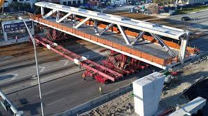

FIU pedestrian bridge install left it vulnerable to collapse, WTH

"The pedestrian bridge in Miami that collapsed Thursday had only been put in place on Saturday under a process that allowed for installation of large sections — but that experts said left it vulnerable to collapse until it was complete."
From, https://www.usatoday.com/story/news/2018/03/15/fiu-pedestrian-bridge-design/429978002/
Which branch of engineering will likely own this tragedy?
Maybe some clues here, http://www.dailymail.co.uk/news/art...amis-instant-bridge-collapses-violations.html

On the TV news just now, they said that the bridge was undergoing pre-opening stress tests, either when it collapsed or just before. That might be part of the final analysis...
I'm not sure of the procedure for a stress test but they were working on something.
Aerial view of a collapsed pedestrian bridge over a busy road, its concrete deck tilted and broken onto the traffic lanes, with emergency personnel and vehicles on the scene and a crane at the right edge.
In the video you can see the crane in place before it's moved out of the way.
  • Aerial view of a collapsed pedestrian bridge over a busy road, its concrete deck tilted and broken onto the traffic lanes, with emergency personnel and vehicles on the scene and a crane at the right edge.
Looks like they were tightening the cables when it collapsed:
https://www.cnn.com/2018/03/16/us/bridge-collapse-florida/index.html
Florida Sen. Marco Rubio, who visited the bridge site Thursday, posted on Twitter: "The cables that suspend the #Miami bridge had loosened & the engineering firm ordered that they be tightened. They were being tightened when it collapsed today." Rubio has been a visiting professor at the university for the past 10 years.
This is hardly the first bridge to be constructed this way. It's a relatively new technique, but it isn't truly first-of-its-kind, and I suspect the method will become more and more common in the coming years because it is pretty wonderful. My point being that I really don't think this was a problem related to the concept of how the bridge was meant to be built. Even if the bridge is technically weaker before the installation is final, this would have been expected and the initial installation would have been designed to make it plenty strong under any expected load.
This leaves two possibilities: either it was an engineering problem with this particular bridge (some kind of design error) or else it was a construction problem (a bad procedure or someone taking a shortcut). My guess is it will turn out to be a construction problem. As soon as they realized the cables were loose, they should have closed the road. Failing that, as soon as they decided to tighten the cables, they should have closed the road. This is going to almost certainly fall on the shoulders of the construction foreman who should have known better. You don't screw with a structure like that while traffic is moving beneath it.
EDIT: A manufacturing defect could also explain it. For example, perhaps one of the cables had a defect, and had, in fact stretched a bit instead of loosening as described in the article. That would imply it was past the yield stress of the cable and the act of tightening it would have rapidly led to a failure. That's pure speculation on my part, of course, but it's a plausible explanation. Again, though, they should have closed the road.

Once you strip it all down the bridge is just an I-beam. Did the vertical supports just disconnect from the upper/lower plates?
If I had to bet on the mode of failure, I would guess that one of the prestressed concrete diagonals was crushed slightly during the move and install. That would have slackened the enclosed diagonal tension wires. The mistake would then be to tighten the slack wires which would cause further collapse of the concrete under compression. It would also pull the top and bottom plates out of their planes and transfer compression to adjacent diagonals. The beam would then fail in the traditional way, by catastrophic buckling of the top plate under compression, with asymmetric off-axis forces.

There's a fellow on internet named "AVE" who postulates a tendon failed during tensioning.
Top image is a snip from his sixteen minute video. He thinks that's a hydraulic tensioner still connected to a tendon rod protruding out the end of a failed cross member joint near north end.
bottom image is my snip from a grainy TV newscast,, security cam at instant of collapse with my annotations.

Zoomed clip of the best video I've seen of the drop. The diagonal support just left of the crane seems to disconnect at the very start of the drop.

The car-cam video is slow frame rate, but examining the surveillance video of the failure shown on the news here gives a greater frame rate. It is subtle, but the upper plate appears to shudder and rock momentarily sideways, a slow wave then travels along the T top plate and is reflected back to the trigger point where the failure then occurs and where more complex waves form. That makes me think a tension cable snapped, triggering two waves, one towards each end of the bridge. Both waves were reflected efficiently from the open plate ends, the (standing wave) sum of the deflections then causing failure of the upper plate at the weakened point.
The design plans for the bridge show a (north, river end) tower with cable stays that line up with half the diagonals. Those cable stays had not yet been installed, so the structure needed to be temporarily carried during construction by a much greater compression in the top plate. Once stayed, the upper plate would not be under such a high compression and would then function as a cover over the suspended walkway. I believe that was the reason why during installation it was left “vulnerable to collapse”.
In my opinion, the I beam design did not sufficiently constrain the top plate to prevent buckling during construction. It was probably the failure of one off-centre cable, then a doubling of the amplitude by the standing wave formation that exceeded the top plate specifications. I suspect the dynamic doubling of the amplitude due to wave reflection would not have been considered when designing the top plate for construction.
It may go back to the beginning of the design when the “open look” of one central line of stays attracted attention to the prejudice of stability. If a box form had been used with two lines of stays, one on each side, the top plate could not have rocked. During construction, the one line of cable stays along the centre line allowed one too many degrees of freedom.
A good engineer will work out the strength requirement, then double it. But when reflected waves are involved, the deflection can double and so come back to bite the engineer. After the tragedy it is more important to identify the failure mechanism than it is to prosecute and punish. The engineers involved are also victims.
The emotive term “stress test” implies a deliberate approach to the point of failure. The adjustment of cable tension after the move would have been expected. That was probably what they were doing when the cable snapped and the stored energy in the structure was released.
I may be totally wrong, but it seems to me to be the simplest explanation of how such a tragedy might happen.
Stored energy will get you everytime.
