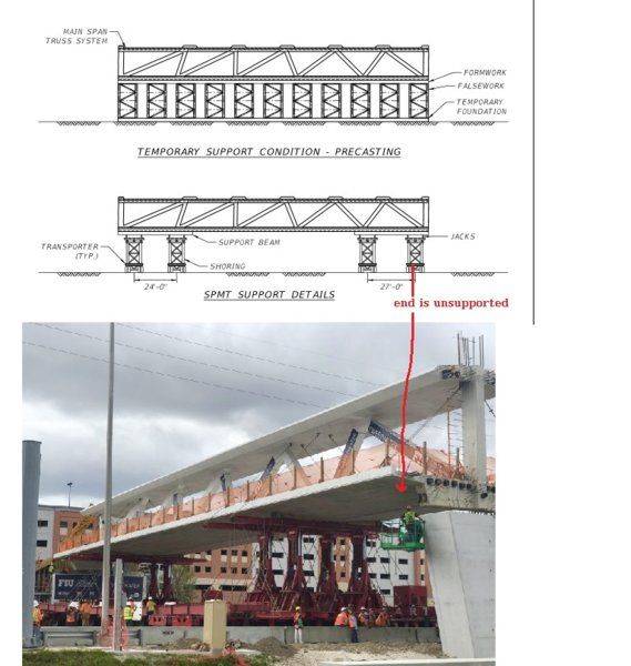

During the move might that diagonal have been in tension? Note the moving rig was well inboard from that end to clear the concrete traffic barrier down on the road.

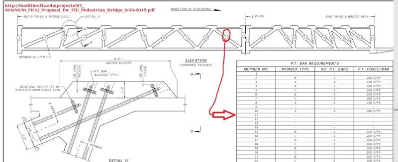

This is from the proposal so not an "As Built" drawing..
http://facilities.fiu.edu/projects/BT_904/MCM_FIGG_Proposal_for_FIU_Pedestrian_Bridge_9-30-2015.pdf
so we'll have to wait on the trickle of information.
@Baluncore - that AVE youtube video pointed out when they lifted the span that end was cantilevered - wouldn't that put north-most diagonal #11 in tension?
Hopefully somebody made provision for the "As Lifted" transporter arrangement...

So if they forgot to tension 11 when they changed the lifting plan that would account for the report of "slack cables" and cracking.

It looks like they calculated beam 11 didn't need to be post tensioned, presumably because they thought it would be in compression while rhe bridge was moved and when the bridge was fully errected.
However when the lifting tressle was moved inboard this caused the north end to be cantilevered and beam 11 to be in tension, possibly causing the reported cracking?
My guess is they realized beam 11 was in tension when investigating the cracks and were trying to post tension it when it failed.

Some of the documents (see post #35) appear to show there were no reinforcement bars in elements 9 and 11-14 and hence there is no value for the "P.T force/bar" in the table for those elements. This suggests they weren't expecting these elements to be subject to tension loads but tension loads may have occurred when they changed how the bridge was moved into place.
To add confusion photos appear to show there were bars in element 11. Perhaps they put bars in element 11 "just in case" but never tensioned them because they thought they weren't needed because they always expected compression loads?
That's the 64 dollar question to me right now.
Was #11 built per that preliminary drawing without a tensioning rod to keep the concrete in compression under tensile load?
If not, did cantilevering that end of the beam edit bridge during transport apply tension to diagonal #11 ?

But beam 11 was only in tension during the move. I notice some reinforcing steel showing in the crushed concrete and I would expect that steel to support the weight of the short cantilever during transport. Any cracks that did open in member 11 during transport would have closed when it was seated.
The situation changed completely when the truss was positioned and seated on the end points only. Then members 2 and 11 would be under their highest compressive load, along with the top plate. Once that situation was present, any tendon under tension in member 11 would be a liability as it would increase the total load carried by the concrete in 11, without advantage. I suspect that was why no PT bar tendons were specified for member 11 in the original proposal.

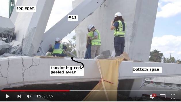

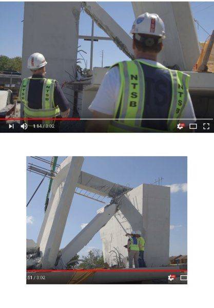

member 11 from youtube , B1PPqa9cS-k
from NTSB video at youtube.com/watch?v=aeJKqojmHgY&feature=youtu.be&t=1m25s
looks like there were tensioning rods in #11
so that question is answered...
